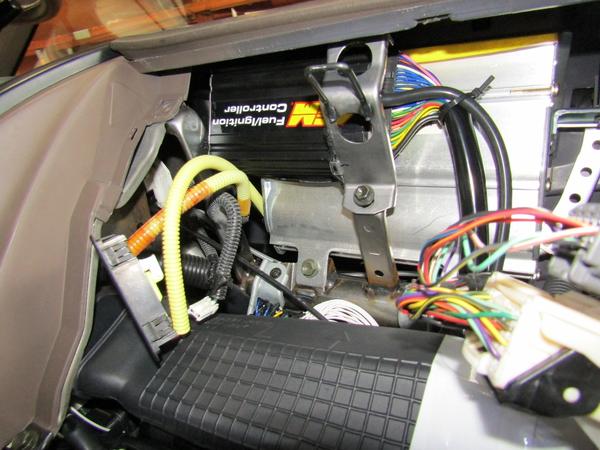

There's space above the top of the glove box. Not the URD unit but picture for reference on where mine is mounted.
What all do you have to remove to get to this area? Just the glove box?

To get to that spot in dash, just pop out the glove box tabs (don't even have to remove the screws) and then remove the top cover and 3 10mm bolts. Disconnect or remove tabs for the complete connectors (that yellow one is your airbag so don't disconnect that one) and you're done.
