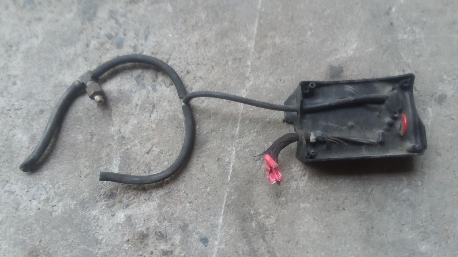

just trying to get/find some info on this:
Came off of a s/c 98 with a 2nd gen. Traced the wires back to a piggyback at the ECU. grd, pwr b+, and the 02 sensor 1 (up steam). Was only using 3 wires, all the rest went no where. The box itself was getting manifold vacuum. i've been searching and looking at pics but haven't find another s/c set up with said.

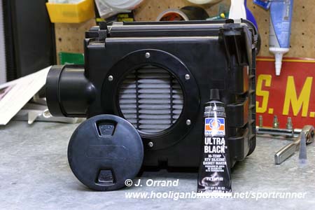

Snorkels and superchargers don't play very nice. A snorkel adds a lot of extra restrictions and bends. The rules of ram air intakes don't apply here either as our 4Runners don't really go fast enough to benefit. Most cars have to see highway speeds or faster to start to benefit from one and almost all snorkels leave the stock elbow in the fender which is a measured intake restriction. The best route I can think of is to add a deckplate to the front of the airbox.
It's cheap and easy to do and best of all, waterproof. Just put the marine grade deckplate back in and you're set for water crossings again. Take it out to gain +10 HP or more. Best bang for the buck power mod for a 4Runner, supercharged or not. From my experience, here's what power you can expect to gain at what cost:

Deckplate mod: +10 HP, $30

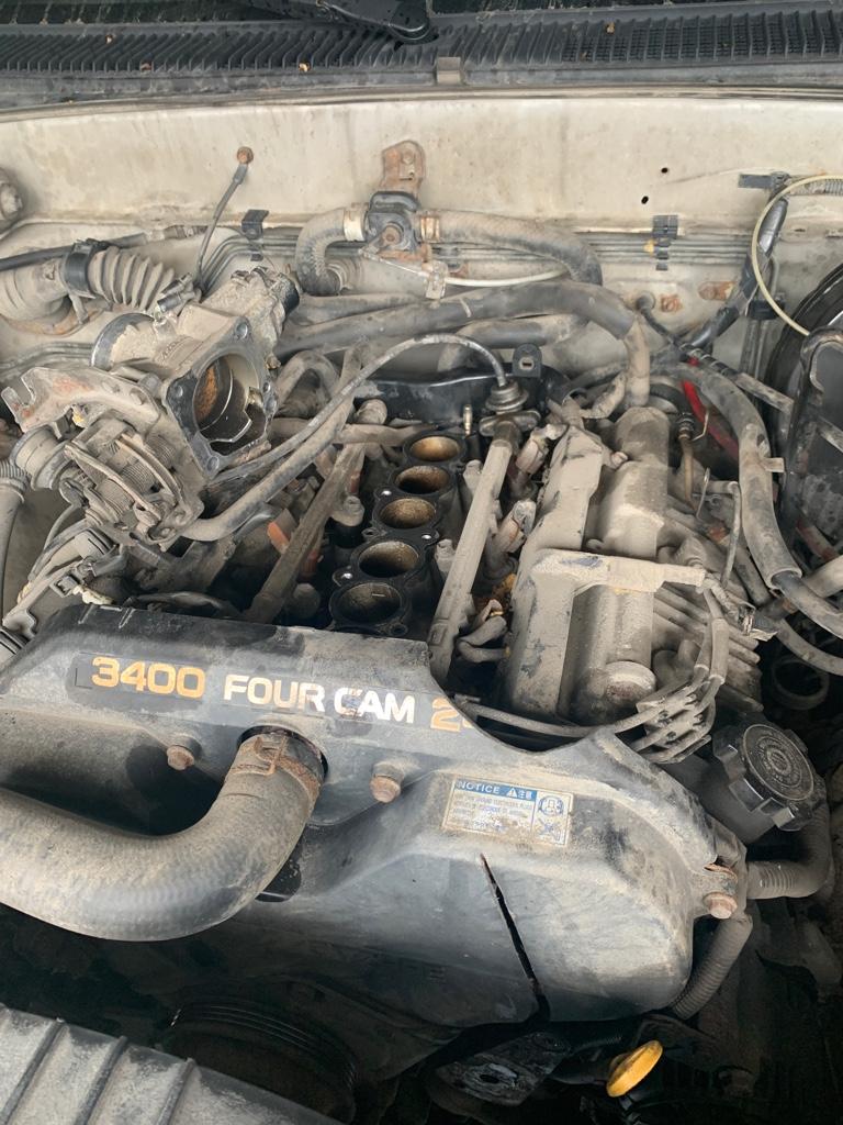

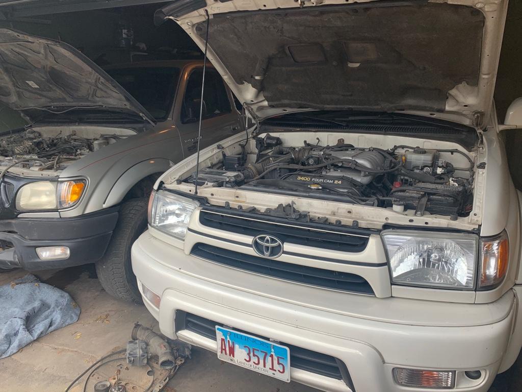

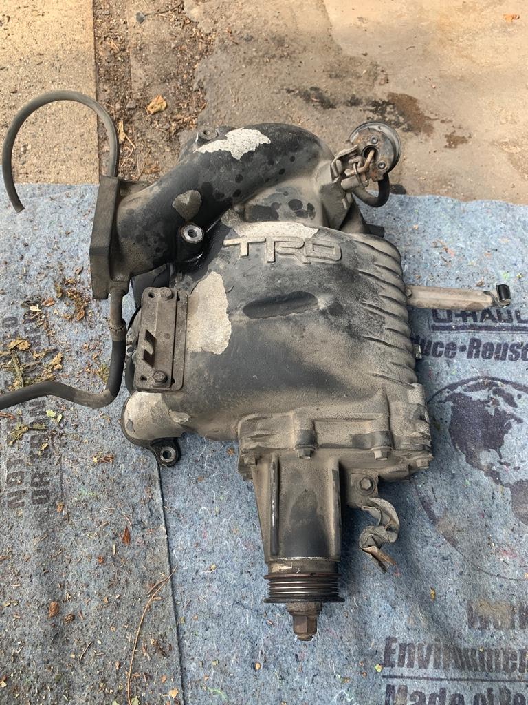

Hey all, I purchased a 1st gen Tacoma with a 2nd gen black supercharger on it to swap onto my 4runner. I was able to get the supercharger itself off of the Tacoma, however I ran into an issue trying to get the 6mm hex bolt off of the dynamic tensioner.
Here are some pics of the set up I'm working with in my garage. Don't mind the dirty garage, I just bought this house and I still haven't had time to clean because I'm prioritizing the important stuff like supercharging my 20 year old truck!
My 4runner!
This is the Tacoma 3.4l after removing the supercharger. Whoever owned this truck treated it like CRAP! Both valve cover gaskets are shot, and it's throwing codes for a knock sensor and a O2 sensor, all of which I'l be replacing before installing the intake manifold from my 4runner.

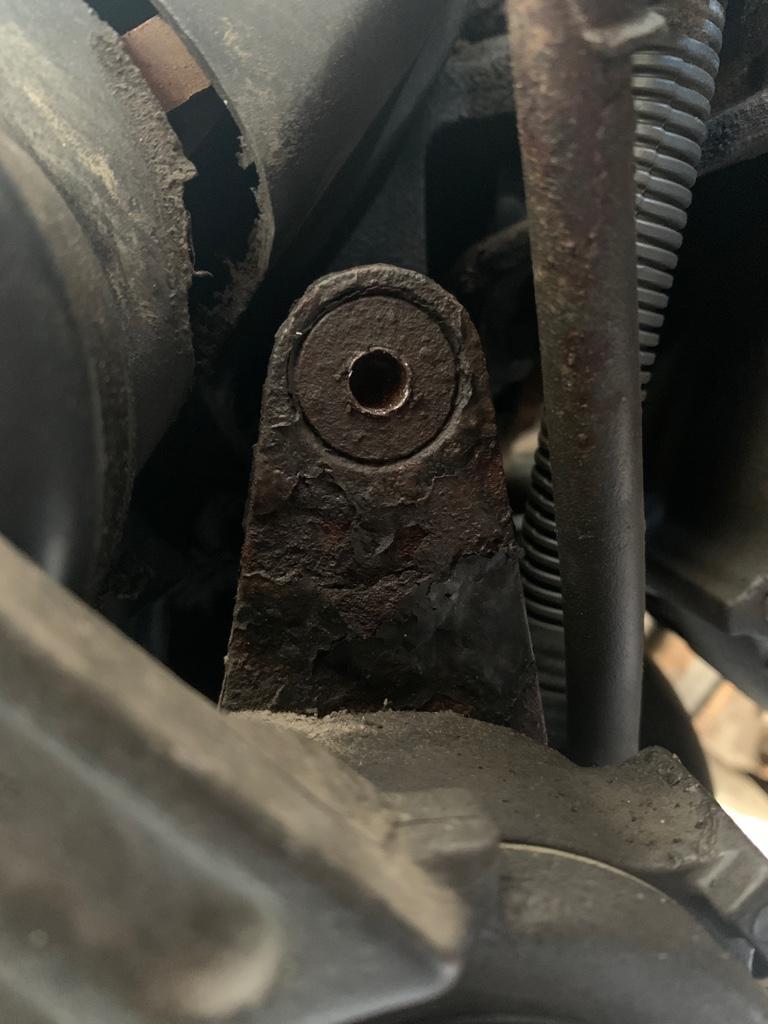

Take a look at this, whoever installed this tensioner must have used the wrong size hex bit :shrug:
I already tried the trick where you hammer in a larger size torx bit, but sadly thats not working. Anyone else have any idea on how I can get this thing off? Heat, drill, dynamite?

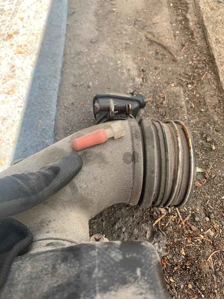

Also, I noticed this plug and red cap on the intake tube. Is this evidence of the truck being meth injected at some point in its life?
Any help would be appreciated, thanks!

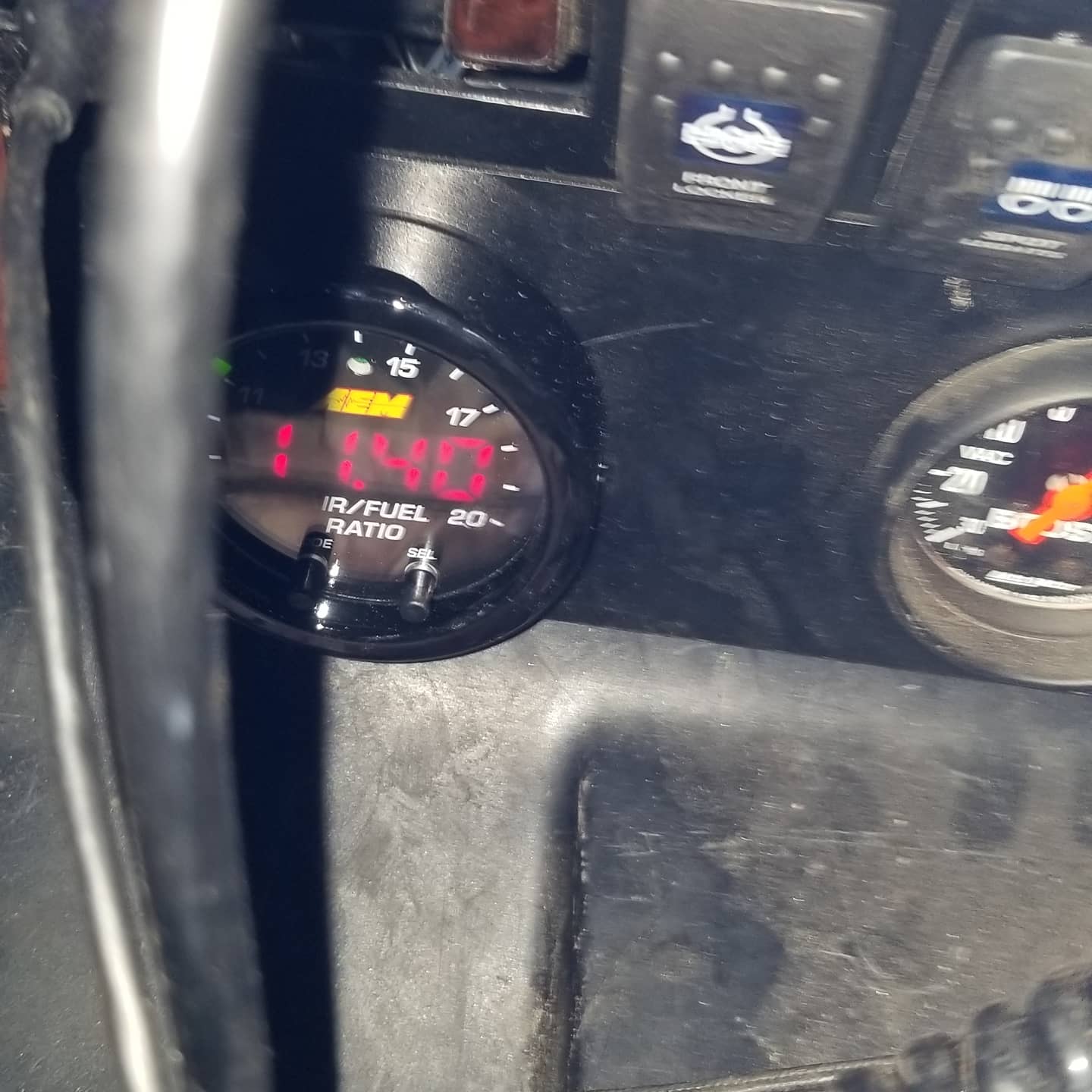

stock 1gen Sc no piggy no fuel mod, 252k on motor w/aem wideband 6psi pull wot [email protected] not bad for being stock. no mod no pinging issues.

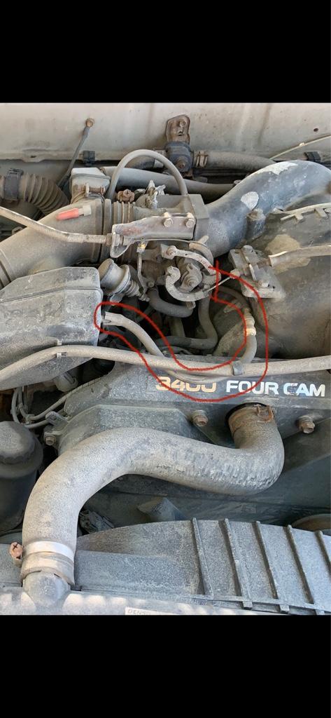

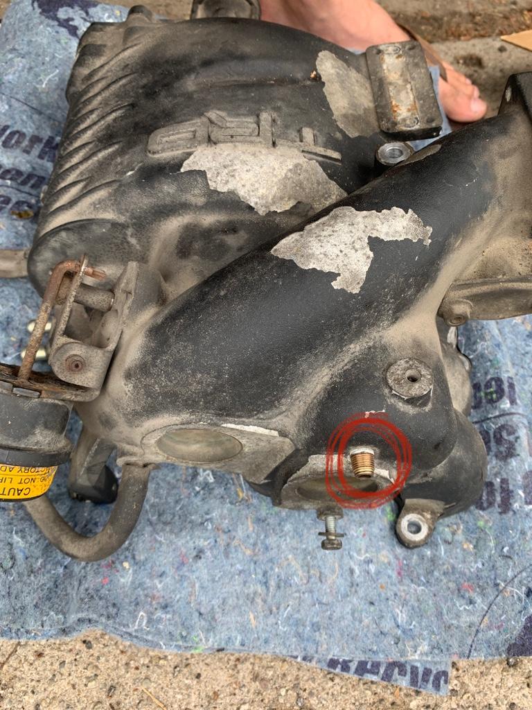

Hey guys, I ran into an issue with installing my 2nd gen supercharger. I pulled the charger from a 5 speed 2002 Tacoma 4wd. I am putting it into my auto 2002 4runner 4wd.
On the back of my supercharger, the previous owner was running a fitting that connected directly into the boost gauge. See below, don’t mind the chipped paint, it’s been repainted now.
However, after watching Timmy The Toolman’s video on installing the supercharger, it looks like this port is supposed to have a 1/8” national pipe fitting for a vacuum hose that goes to the fuel pressure regulator. A boost gauge then can get T’d into this fuel pressure vacuum line.
Anyone else have this issue?

Yep, someone replaced it. My guess is they broke the barb off and then had to improvise. I would take it out (the teflon tape shows it's threaded) and see if you can find a barbed fitting for the boost hose that has the same NPT thread size as the current fitting. You are going to have to get a little creative as that port is necessary for the install. It needs to connect to the vacuum line going to your Fuel Pressure Regulator that sits on the back of the fuel rails.
Thanks for the advice. I'm going to run to Home Depot/Menards/Lowes tomorrow to see if I can find the correct brass barb. If I can find one, I'm going to install it correctly and T off the boost gauge. If I can't find one, the way the supercharger was set up on the Tacoma is the vacuum line from the fuel pressure regulator was going to the trucks intake silencer. Anyone know if that will cause any issues? Here is a photo, the vacuum line circled in red was connected to the fuel pressure regulator.

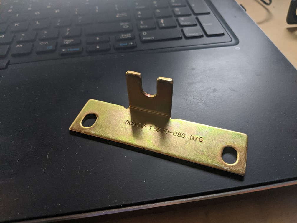

Now I have another issue, I need the proper throttle bracket for my 4runner as the one from the Tacoma is pointed down and more towards the front of the engine bay. I need the bracket that holds the cable straight up and down and towards the center of the bracket. Does anyone have one for sale leftover from a supercharger install kit? Really not trying to pay $170 for a single bracket.
Is this the one your looking for? I just installed mine and had this left over.

I missed this question the first time. What you'll do is put a cap on the resonator box on the intake where the hose starts. You don't need that connection anymore. The hose will just go from the fuel pressure regulator to the boost port on the back. That's how TRD's install instructions show it after they revised it. Your setup is how it was back when they first released the supercharger and didn't know the boost pressure increases fuel pressure.
Thanks, I was able to look at the vacuum line diagrams using the TRD instructions. I just wasn't sure if I could still run the supercharger on my 4runner the same way that it was set up on the Tacoma using that intake silencer. I was able to rig it up so that its running now (FPR to boost port) so that I can get to a parts store to look for the correct pipe fitting for the back of the supercharger.

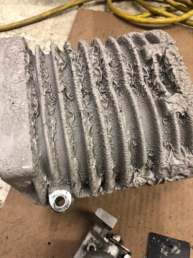

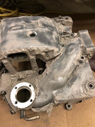

I’m in the process of slowly rebuilding this 1st gen supercharger. The paint on it was pretty wrecked, and I also hate the tan color, so I’m stripping it all off
I was thinking that just leaving it raw aluminum is pretty boss. But then I thought that maybe the tan paint had some thermal dispersion properties.
So now I’m thinking about doing something like Cerakote or Zybar

Any word on whether either the gen 1 or gen 2 superchargers have a heat dispersion coating on them and opinions on whether it’s worth it for me to put one on?
Edit - I called Magnuson and the guy said the paint doesn’t have any thermal properties and there really wouldn’t be any benefit to a heat dispersing coating. Maybe I’ll just leave it raw aluminum or polish it up shiny.

Be sure to spray it with clearcoat to keep it from oxidizing.
Good tip, I actually had just assumed since it’s aluminum I wouldn’t have to worry about corrosion and it would just stay shiny and polished forever. You’re probably right though that it’ll fade if I don’t do something.
