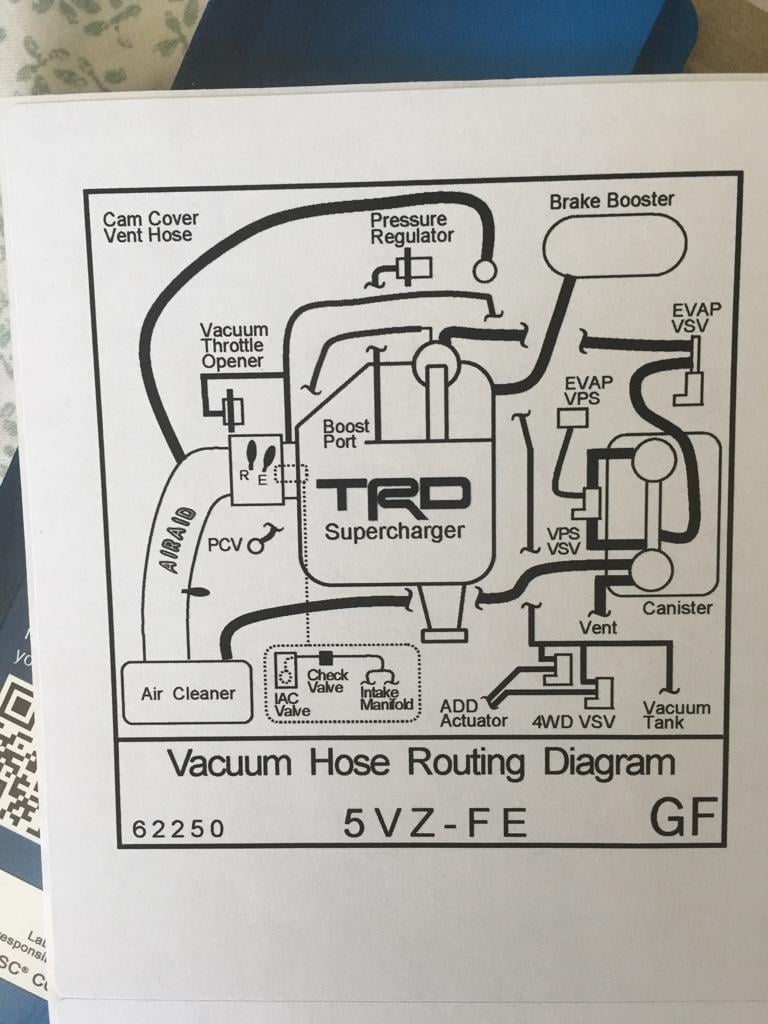

Just received my "1st gen" TRD Supercharger for my 2000!! I've noticed a few different things from the 1st gen and later gen superchargers on the 3.4. The 2nd gen has a hose fitment right on the throttle body for the PCV valve and the 1st gen does not.. I have looked for other places on the 1st gen and cant find a fitting for the PCV valve. Did some research and cant seem to find an answer??
Yes!! I saw that fitting but it’s so far back I didn’t think it would reach that far. It’s just odd to me it all way in the back on the gray one and right there on the side for the 2nd gen
Seems like you already got it figured out. But anyway, I have this vacuum decal I made for member who had a 1st gen. I don’t own a 1st gen to verify, but the member claimed it was correct.
