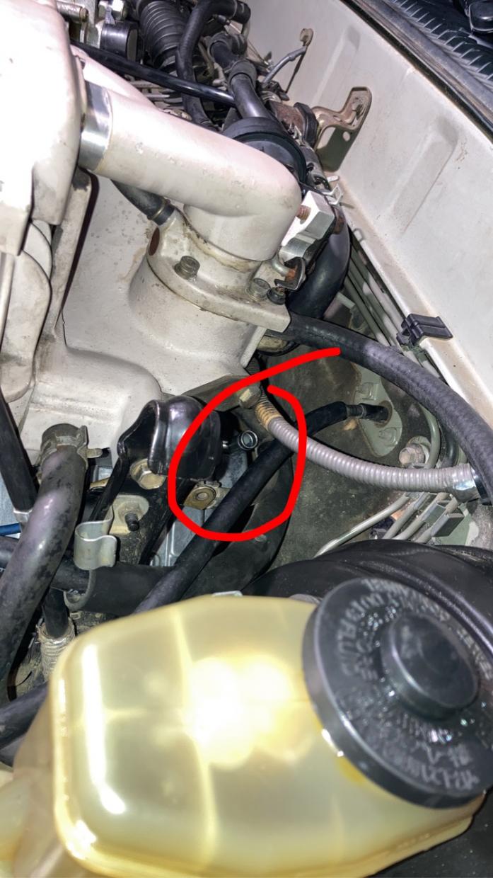

Installing the supercharger today and trying to find a destination for the valve cover vacuum port on the drivers side and where it runs to?

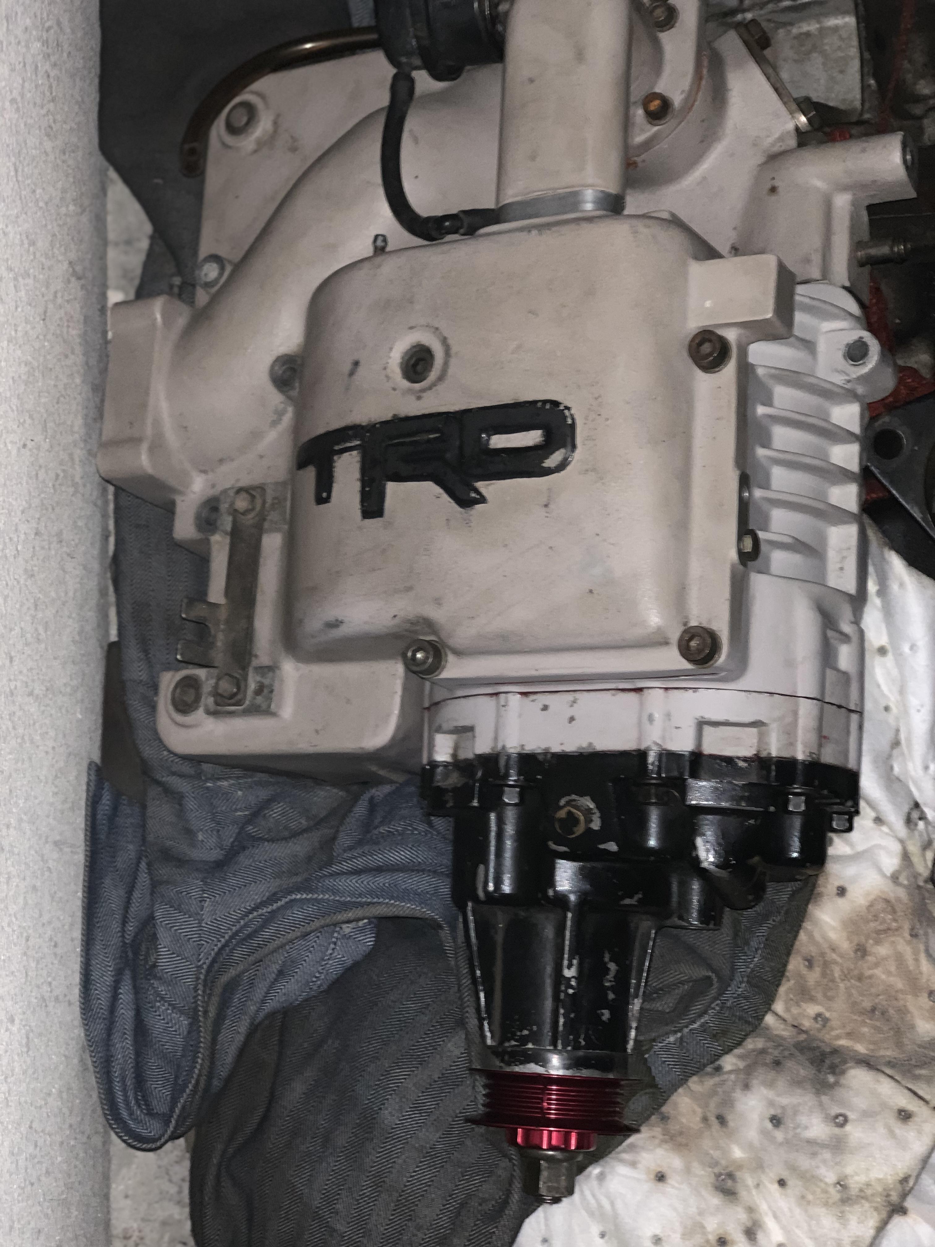

I just started pulling apart my 1st gen SC with the intent to refurb the nose cone and hopefully replace the rear needle bearings as well. Two questions that have cropped up:
1. Is there a trick to removing the rotor pack/rotor plate? On the 1st gen, there isn't a lip or any sort of tabs on the rotor plate to pry against. The nose cone has nice tabs to pry it off, but the plate seems quite stuck and isn't responding to general tapping. Should I (or shouldn't I) apply some heat to try and release the gasket bond?
2. Is it OK to just replace the rear needle bearings and not mess with the rotor plate bearings (and corresponding seals)? Contingent on the front rotor bearings feeling OK, of course.
