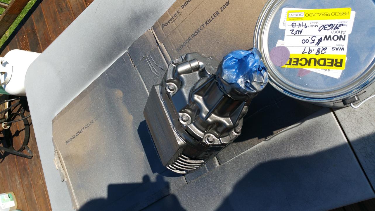

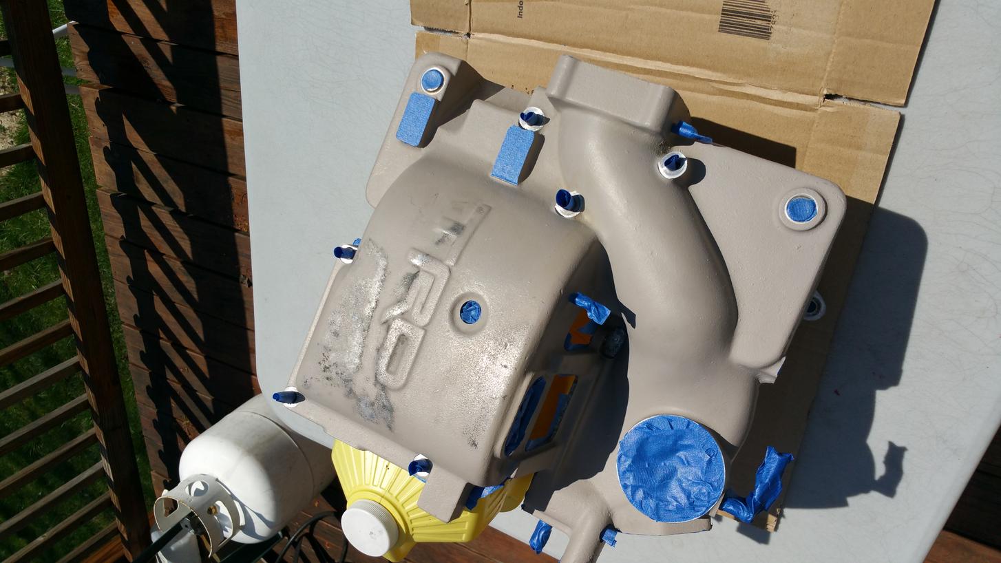

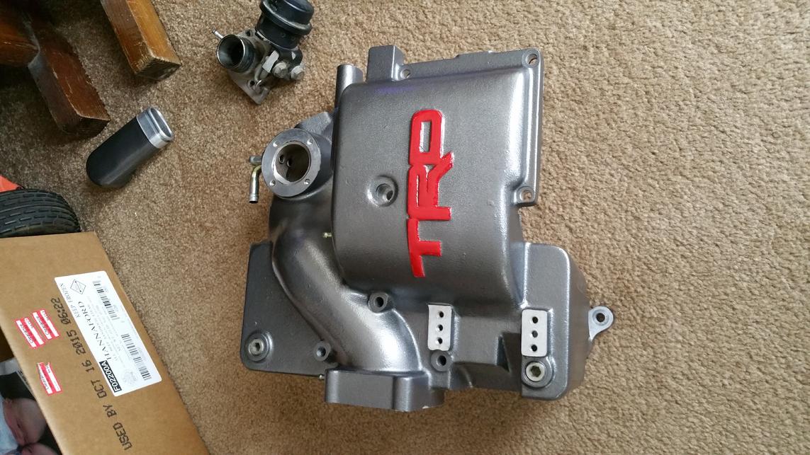

1st gen embree highspeedlab rebuilt and repainted install next.

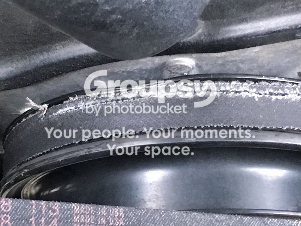

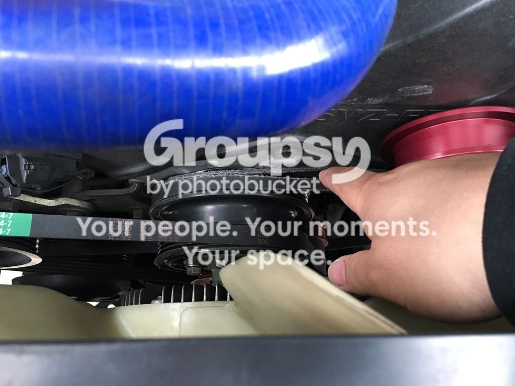

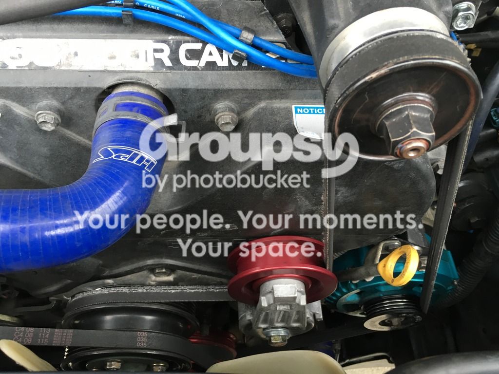

Did you fix your pulley? Was this the cause of your frayed belt? We have almost the same set-up and just was curious the cause of the frayed belt? Is that a DC altenater??
as far as this i am pretty sure it is the pulley that is to blames since the other side of the belt show no damage. i will know once i get the truck back from the mechanic. i just havent had time to do the work myself with a child and a newborn to care for. as far as the Alternator yes it is a DC alt.
