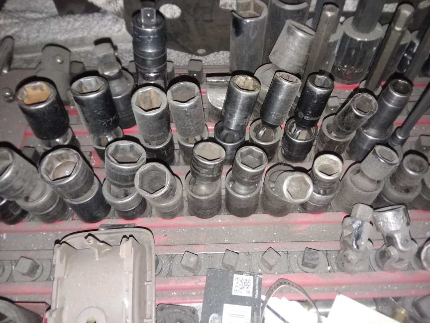

Starter replacement job. I'm assuming it's the bolt that's clearly visible and not the top left one that needs to be removed, correct?

Correct. The not hidden/bolt on the right is for the starter.
Well this thing has been a royal pain so I stopped for the day. I ended up getting a bolt extractor set from Harbor Freight, and the extractor fits and will bite, I just can't seem to get a good angle on it due to the lack of space available in that area to manipulate a wrench.
Not sure what my next move with it will be. Whether I have someone try to help me or just take it to a shop and say here, I have the parts I just need the labor. I'd rather do it myself with help instead of having to pay to have it done, but any suggestions are definitely appreciated and welcomed.

Tried the impact, too. I'm going to call around to local shops tomorrow to get quotes for labor. If it's not unreasonable I may just pay to have it done. Even tried a bolt extractor. I just can't get enough movement down there.

One thing I've done in the past when I couldn't get a rounded bolt out is weld a socket to the bolt and twist it out with the impact. Just make sure you don't weld the bolt to the starter! lol. Just use a socket you don't mind having to chuck afterwards. Obviously you can only do this if you have access to a welder. Just a thought!

Take a road trip...I get it out by welding a socket to it or grinding the head off then welding a nut back on to unscrew the bolt out of the starter...:-) Besides its alot easier to get in there with a car lift.
