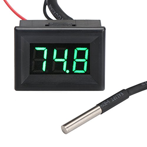

Has anyone added an external ambient temperature sensor that displays Fahrenheit? Trying to find alternatives to the Subaru FMU and Gentex mirrors. I ordered an eBay one and a couple of aliexpress ones to consider.
If you find one, please let us know. I had this one in the past, but it's been out of stock for years - Buy DROK 0.36" LED Digital Thermometer -67 to +257 ℉ Fahrenheit Temperature Meter Gauge DC 12V 24V 18B20 Probe 1 Meter Sensor Cable for Car Fridge Refrigerator Aquarium (Green) Online at desertcart OMAN.
It was great for a year, then died. I haven't been able to find another one ever since, they are all in Celsius. This is probably the closest I found, it seems to be in Fahrenheit, but also has a voltmeter - Battery Voltage Temperature Monitor Meter
