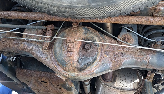

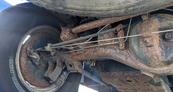

Hey all, new member here in the market for a 3rd Gen. I've found one that looks solid other than a bit of frame rust, which is to be expected for a 20+ yr old vehicle in Northern VA. I don't mind immediately putting a little money in to take care of it, but I'm wondering if this is likely to be a sand+repaint job or a welding job. I'm particularly worried about the lateral control rod mount on the left side. Any thoughts?

It's difficult to say based on pictures. I would hit the mount with a decent sized hammer to test the integrity

Bonjour. Fellow NOVA owner here. I will say this does look pretty rough, but I agree with Bad Luck. See what happens when you hit it. My truck didn't spend most of it's life up here, but I've been up here the past couple of years. You know they salt these roads when it gets cold and the idea of a single drop of snow.
