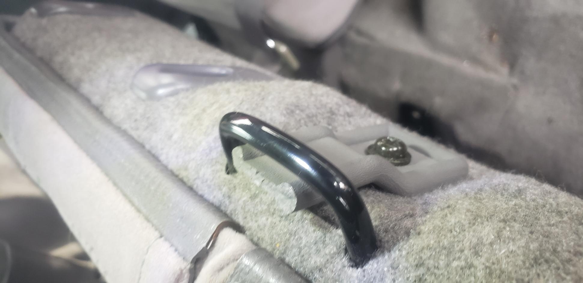

There's a plastic clip underneath my rear fold down seat thats broken. Which is concerning because my kids car seat sits on top of the rear seat. I can't find this plastic clip anywhere. I'm not even sure if I'm using the correct terminology buts it's not in the operators manual, its not in the maintenance manual and I can't find it on rock auto please help
Can you post a photo of the broken part?

Gen 3 4 runner Broken piece that holds down rear seat
What is the proper designation for this grey clip it clip underneath the top piece of the rear seat

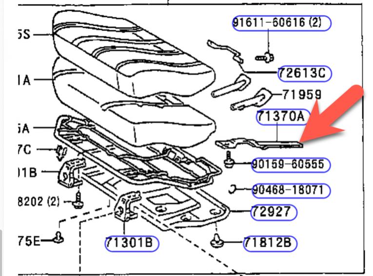

Looks like Seat Frame Bracket (Rear) but for $70 I'll stick with pulling on the loop that remains after I broke mine.
EDIT: In fact, that's how I've been pulling up the rear driver side seat for the past decade. I'd forgotten about breaking that piece years ago.

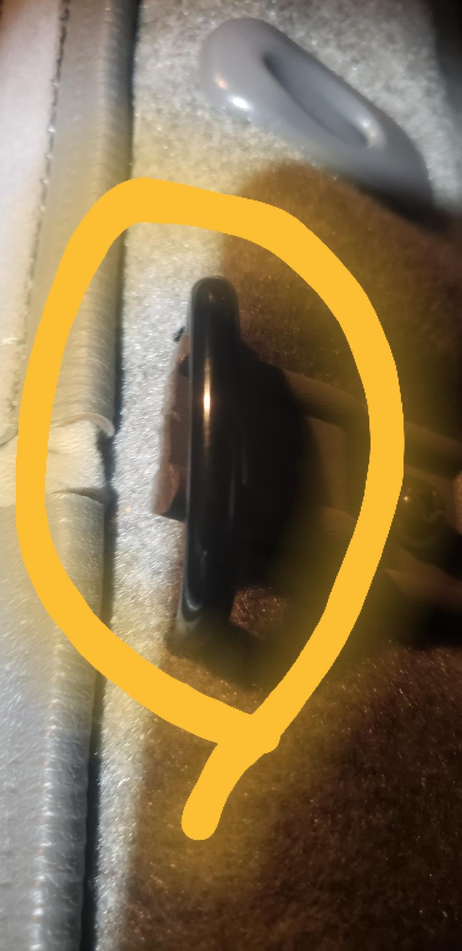

It's difficult to say based on pictures. I would hit the mount with a decent sized hammer to test the integrity
Bonjour. Fellow NOVA owner here. I will say this does look pretty rough, but I agree with Bad Luck. See what happens when you hit it. My truck didn't spend most of it's life up here, but I've been up here the past couple of years. You know they salt these roads when it gets cold and the idea of a single drop of snow.
Thanks guys, with this advice and that of some other parties I decided to give it a pass. I'll keep lookin!

Nice find, I looked right past it. Only $14 from Amayama (plus shipping, of course, so may want to combine with other goodies) - Buy Genuine Toyota 7137035010E0 (71370-35010-E0) Holder Assy, Rear Seat Cushion. Prices, fast shipping, photos, weight - Amayama

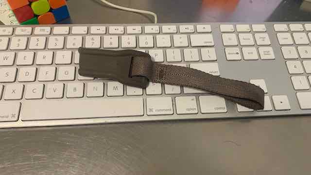

The pull tab part number 71370-35010-E0. . This is oak color.
