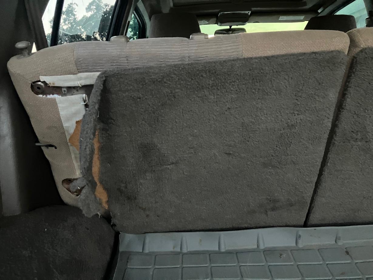

Has anyone repaired the back of their back seat? I recently picked up a 2000sr5 that it looks like the previous owners dog got ahold to. Iv had trouble finding out which material to use and how to reattach it.4r.jpg

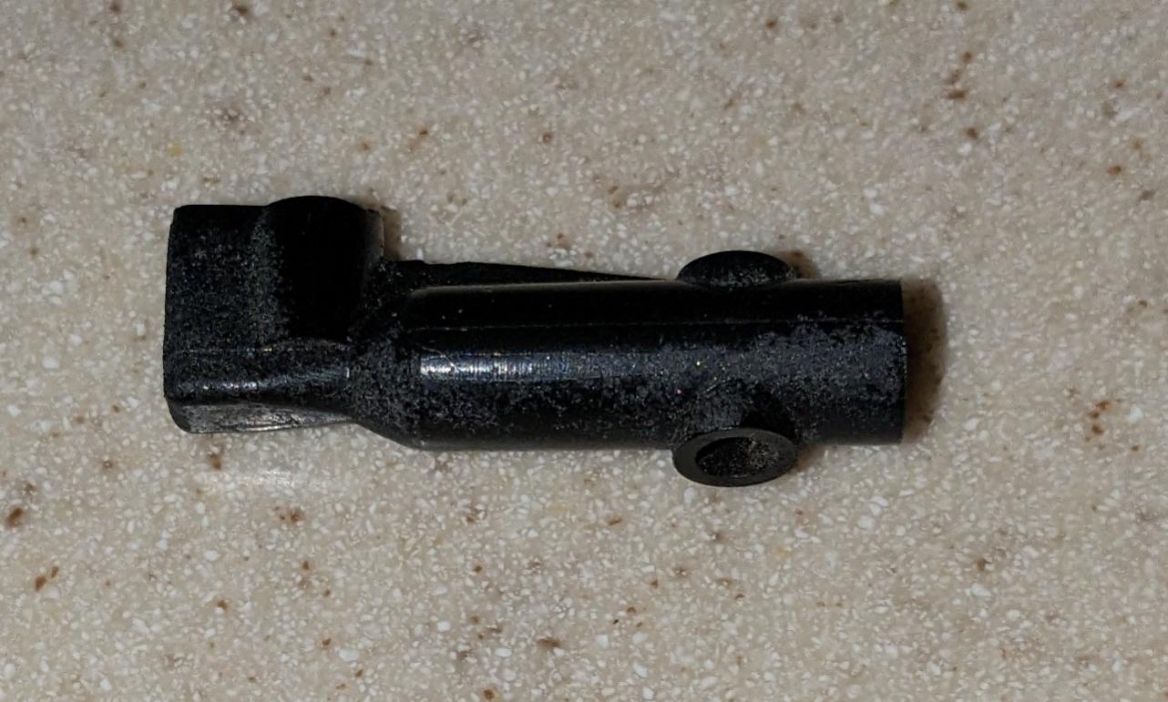

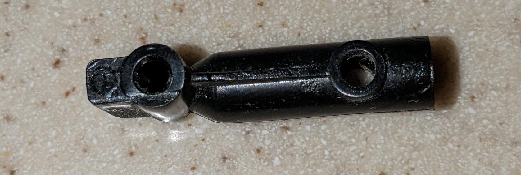

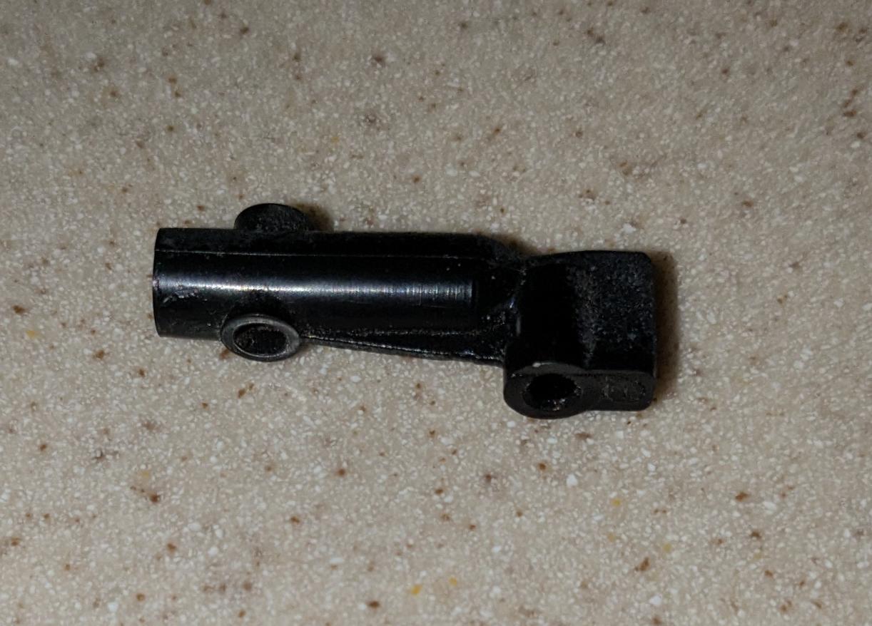

2002 4runner mystery part - What the heck is this for?
I was performing the door actuator motor swap and found this part in the bottom of the door. It's approximately 1.25 inches long and made of pliable rubber. Anyone know what it is or what it's for? Is it even part of the vehicle!?
Thanks!
