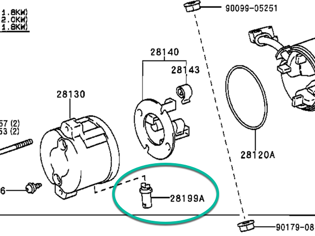

Found this in the driveway after replacing my starter contacts.
I thought it was the part shown below, but I just went out to check and it's still there.
As far as I can tell there's only supposed to be 1 on the starter and I can't find the part being used elsewhere.
Any thoughts?
28199-74110
Thanks!
Any thoughts?
28199-74110
Thanks!
There are actually two of these dust protectors on the starter, one on the solenoid and one on the body. Here they are on my starter:
Thanks, Leon. I wonder why they only show the upper one in the parts diagram.

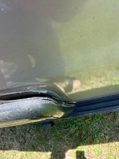

Hey guys, I’m trying to figure out the best way to attach this back (tailgate hatch). I usually would do super glue but I don’t know if that’s the play here. Or should I just buy another rubber weather strip and use the adhesive that comes with it?
