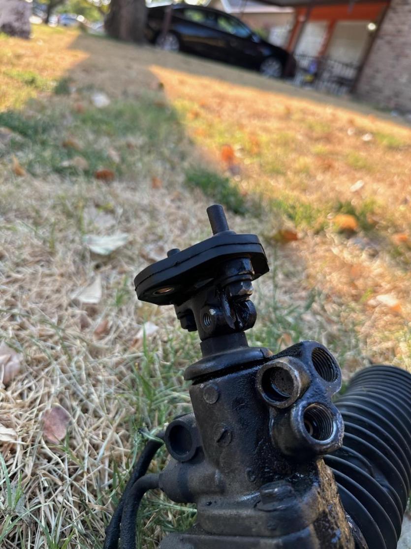

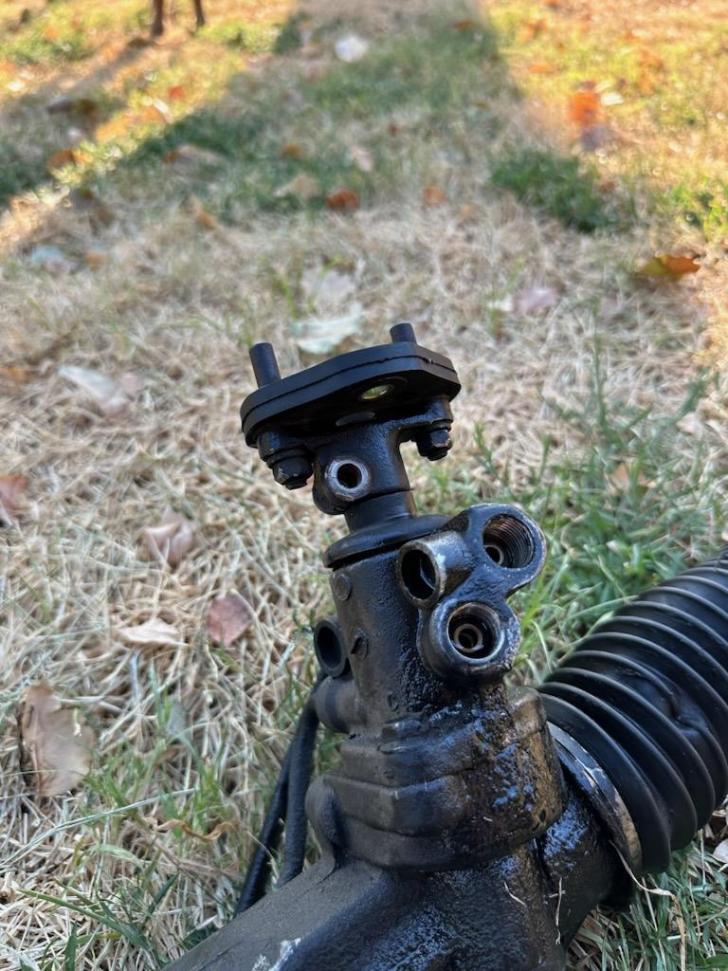

Any tips on removing this from the steering rack? To install on the replacement?
When I swapped racks on a 250k mi truck, I soaked in PB Blaster and than whacked it with a mallet until it broke free. I'm not in the rust belt, but it was pretty seized on I'm guessing from age and mileage. Once off, I cleaned up the threads and used lithium grease to help get it on the new rack
