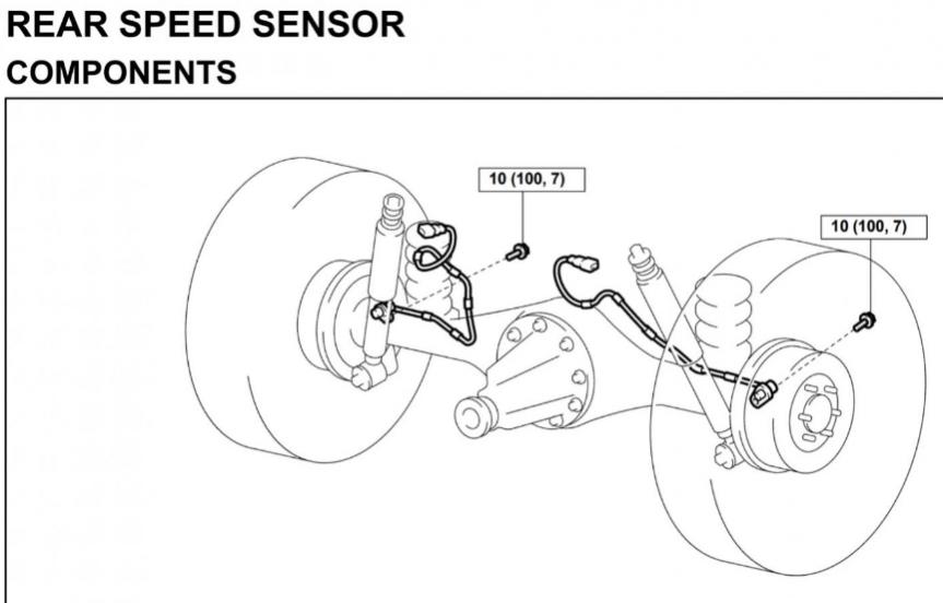

My issue comes in identifying what kind of rear differential my 4runner has, it has no numbers of stamps to confirm its type. I read on the forums that 3rd gen 4runners all used the same V6 rear diff/gear ratio, but there is also the ABS to consider which I don't know if my 4runner has or not (I see the ABS light but I assume that could be manufacturer simplicity). My 4runner is a 1997 3.4L V6,4x4, SR5 package if that helps.
Are there abs sensors underside of the wheel on the diff housing?.. Vin sticker on the driver door for gear ratios.
A03A=4.10
A04A=4.30
A05A=4.56
A03A=4.10
A04A=4.30
A05A=4.56
Thanks for the insight, I will check if I have those sensors. For the gear ratio on my vin, I just checked and its A/TM: A02A/A340F. Do you know if that code is for a rear end from a Tacoma model of the same year?
Update: I checked the rear differential case number stamped on it: 35140 71B
Not sure but A02A is 3.91 gear ratio probably from a tacoma. Not sure if any 3rd gens came with 3.91. 2wd drive models came with 3.73. Hopefully some one with more knowledge can chime in.
