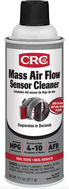

2001 4 Runner Not running well at all- 3 different mechanics
Our 4 Runner (Bertha) has 196,000. We have owned it since 2004. Here is the list of things done in last 2ish years.
8/22/23 flush fuel system
7/23/23 new battery
7/13/23 new air fuel ratio sensor
6/30/23 new spark plugs and wires
7/22/22 New battery & F1 Throttle body
We drove it cross country after this repair and it did GREAT!! Has just been acting up over the last several months.
6/9/21 new tires, rear brake shoes, front upper ball joints, front struts & sway links, timing belt kit with water pump, radiator plastic tank, hoses, thermostat and belts for A/C, alternator, water pump & power steering
It was running okay when the temperature was lower, but drove it home from the fuel system flush and it barely stayed running. Misfires and has very low idle.
Mechanics don't seem to know what to do and we have a pretty car that won't go.
Should we find a new mechanic, sell it to someone who knows 4 runners, or trade it in?
Wanted to keep it going past the 200K mark!
I would appreciate any advice!

I'd check your mass airflow sensor
