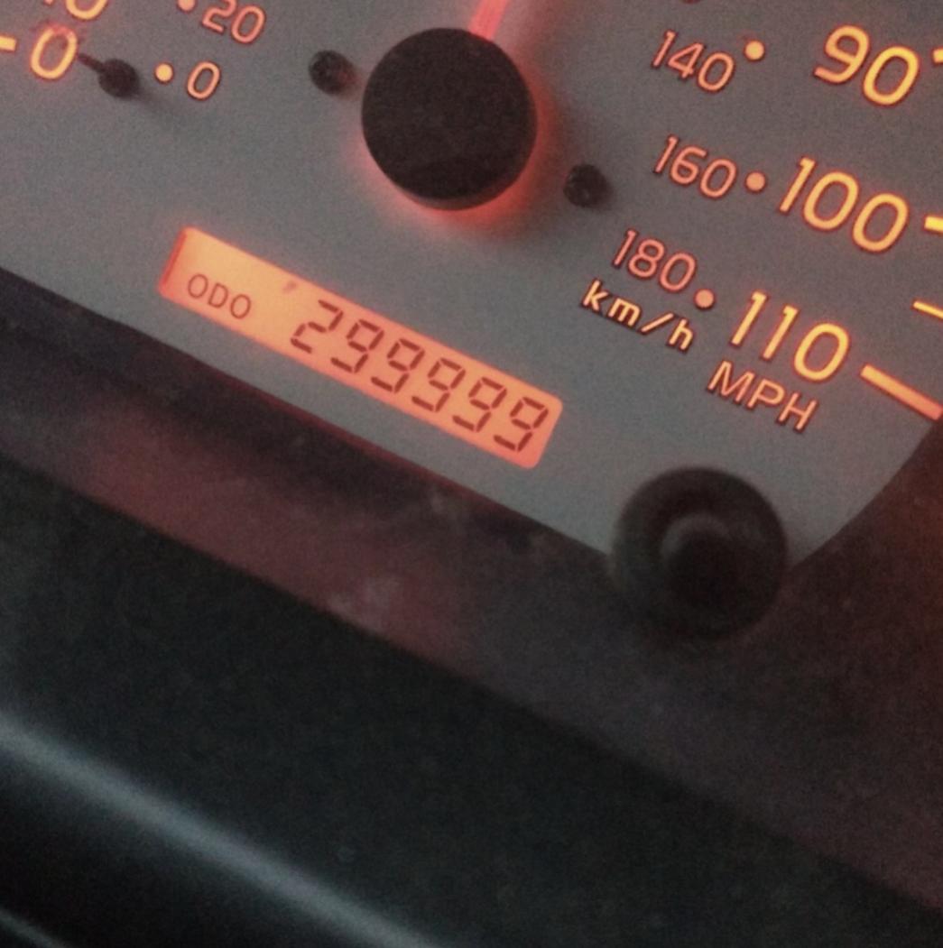

Okay, silly question here but I want to know!
I’d like to change my dash guage lights to be the orange that’s in the late year 1st Gen Tacoma’s, like the one I will attach a photo of here. I have red LED’s currently but they have hot spots and I’m tired of it. Plus I like the way the orange looks! I remember when removing my OEM bulbs that were green, they had a little rubber green tip over the bulbs. Do I need to just go to Toyota and say hey, I need new dash lights for an ‘03 Tacoma? Or can I test my luck with the regular sylvania bulbs I can find locally. Those don’t have any rubber tips over them though. I have an ‘01 so my guage lights should be the 24 bulbs
Everything you could want to know LED Dash lights FAQs

So that’s the thread I read prior to making the above post. I still ask my question because I don’t know if the guage lights to an ‘03 Taco would be the same bulbs as my ‘01 4R, you know what I mean? If they are, then I have no problem going to Toyota and telling them I need ‘03 Tacoma dash lights, but then they’ll spew off part numbers and so on and I don’t have those on hand nor do I know them

I don't know why you're dead set on going to the dealership for LEDs. If you really wanna go the incandescent bulb+cover route, then go pick up a pack from literally any store for probably half the price the dealership would charge; covers might be a little harder to find but damn near anybody should carry the bulbs. Otherwise just pick up some amber #24 or #74 LEDs (both have the same size/style base, #74s are just larger - about twice the size). Most would recommend someone like VLED, including myself. I'd try to avoid cheap chinese crap like superbrightleds, many have had their bulbs flicker or burn out very quickly from them (again, myself included.) Just know that finding that shade of orange is very difficult, I've tried using incandescents+covers, white LEDs+covers, colored LEDs from a number of people AND even colored LEDs+covers and nothing seems to be that shade of orange (in fact they all seem to be the same shade no matter who I bought them from, even between those labeled orange and amber). In the end I went with plain old amber VLEDs because they were the most clear and don't have hotspots. They don't quite match my Tacoma stereo and clock but they're as close as I found.
I would be very shocked if Toyota even still carried the same old bulbs and covers and didn't just hand you a pack of Sylvanias they bought wholesale.
That all being said I would only upgrade the main gauge cluster lights from #24 to #74 bulbs if you decide to. I tried to replace all of mine and everything BUT the main gauges was so stupidly bright it was incredibly distracting (PRNDL, brights, low gas, etc). There's also a number of current bleeds in the dash meaning many (in seemingly random positions) would need to be swapped back to incandescents to avoid this. If you look around you'll see very few people talking about replacing all the #24 bulbs and it's for this reason.

I appreciate your detailed response! I’m not sure if I was clear on what I was trying to say, but all I want to replace are the three main bulbs that illuminate my entire dashboard. I will plan to stick with the #24 bulbs in the meantime as this is what my rig calls for. I’ll test my luck with the Sylvania’s and if they don’t fit, I’ll return them and try again in another way. Won’t be the end of the world, just wanted to hear some other opinions on the matter. Again, thank you for all the info

I'm not sure why that shows 24's. I am not certain that the '01 info is wrong on there, but the 2000 info is wrong as the gauge lights are absolutely 74's. The bases on 24's and 74's are not the same size. 24's are a W2x4.6d base and W2.1x4.9d base. 24's will fit loosely in a 74 holder, 74's won't fit in a 24 holder. I used 74's from SuperbrightLEDs, and had hotspotting. I switched to VLED's 74's and am way happier with the even brightness. This is a new thread which is more correct than the old thread previously linked to.

^^^ This is totally right, I just remembered I initially tried to take out the #74 VLEDs from the PRDNL spots and throw in some incandescent #74 bulbs and they were too wide to fit. Definitely only a one way fit in that regard, my mistake.
On that note, another reason to avoid superbrightleds is many notice the bases (and overall width of the LED) tend to vary and sometimes are too thick to fit. Just another result of cutting corners.
