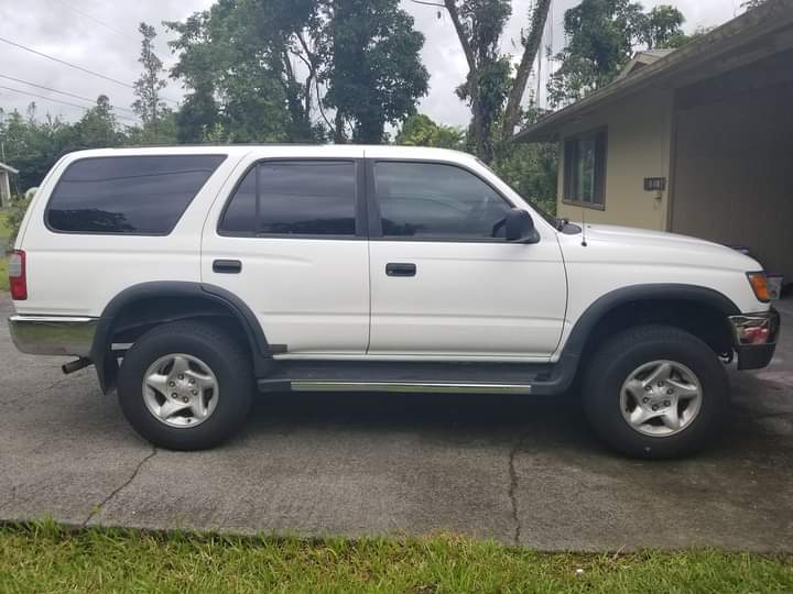

How's it going guys! Finally redid my lift and I'm really happy with the results!
2000 4runner 2WD w/3RZ 2.7l
Bilstein 5100's front and back, OME 880 front, 906 rear, 3rd gen front sway bar links in the back and 2nd gen rear sway bar links in the front.

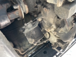

‘99 Limited. Shifted into 4WD, would not shift out. Tried all suggestions, no luck. Finally tapped on what I think to be actuator and it popped out. This is what I tapped on but it does not look like any actuator on net photos. Any thoughts on a maintenance plan before the next CO winter?
