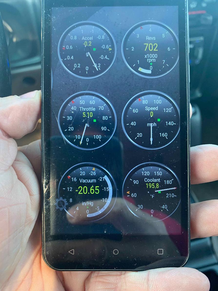

I don't know what I don't know about vacuum. This is probably something obvious but I'm not sure where to start. Apologies if this is way too much information. '96 4x4 auto.
I pulled out the old Android today to check the numbers and noticed the vacuum was reading as a negative number.
I read in this post that it should read -20 at idle (basically sea level in Sacramento) but that doesn't explain the positive reading in earlier pictures (from 6 different dates in the past 8 months). I've read other posts where it's suggested the number should be 17-21 with no mention of negative values. But I suppose that's with a real vacuum gauge, not Torque (ordered a gauge, arrives later today). I realize that side of the gauge has negative numbers. Is it possible the Torque app just never showed the negative sign before for some reason?
I checked all my old images and it's always been positive - like these from when I switched my jiggle valve from 12 - 6 o'clock:
The only thing I can think of that changed was that I cleaned the throttle body when I did the valve cover gaskets last month.
Could it have something to do with this gap? Should I even be able to see light through there? From the posts I've read I was under the impression that was kosher.
It may not have had space to show the negative symbol when the number was in the -20's. Either way, if you ignore the number in the center and look at the analog side of it all the pictures shown are on the negative side of the gauge (the right side). +20 in/hg is about 9 psi so unless you installed a supercharger and pulley you aren't going to ever have that reading.
What threw me for a loop was the negative display. That phone lives in the car with no wi-fi or cell service so the app didn't update. I figured something else must have changed which of course means I did something wrong. Oh well. I'll get back to learning about the vacuum system in the 5VZ-FE. Thanks!
