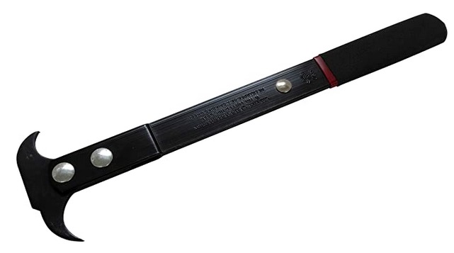

Thanks! I've only used that bent-arm Lisle puller for crank and cam seals. Think the larger Lisle seal puller (that I already own) would suffice or would a slide hammer be a better choice?
I think either tool could potentially work if used right.
Have you watched the Timmy the Toolman video on wheel bearings?
Thanks again. Yep, I've watched that and the manual hub swap video. I should just replace the seal before I talk myself into doing the wheel bearings for the sake of doing them since I've done so much else up front. I mean what the hell, it's only three tanks of gas, right?
