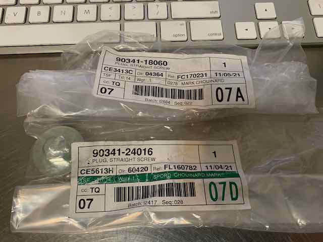

Get the fill plug out first!! :D
And consider replacing the front diff fill and drain plugs with:
- Front diff fill plug Lexus PN 9034118060
- Front diff drain plug Lexus PN 9034124016
