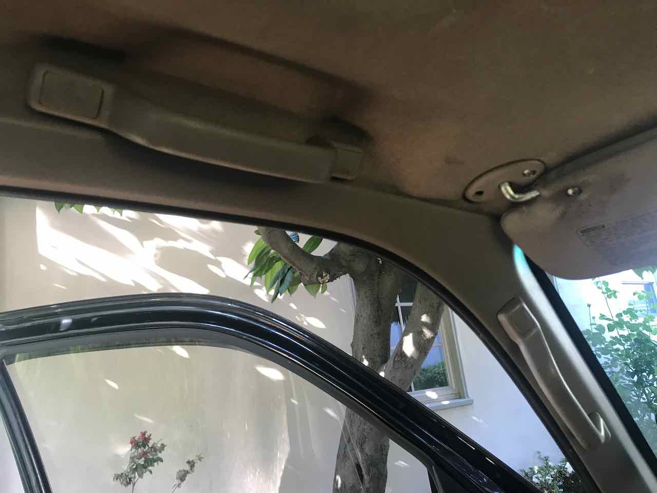

Sitting my rig warming up (yes, I still do that every time) I noticed that on the driver side there is no hand hold like there is on the passenger side in picture, but there are 2 mounting screw holes of the correct dimensions that I can feel behind the fabric - I wonder why. That's all.
Edit - I suppose it means it must have been an 'option'? Man I'm extra dumb today. Dumb In Public.

OK.......dumb question time:

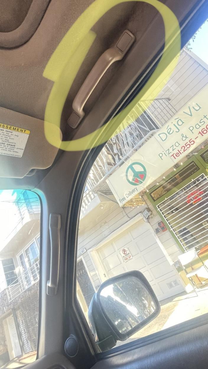

On May 27 of last year I cut a slit in the headliner where there holes are and bolted in a handle I got from Pick-n-Pull. First time I ever really used it has been this week after an old back injury flared up. Glad I did it. (no idea why that picture makes everything look so dirty!)
It's there for right hand drive models

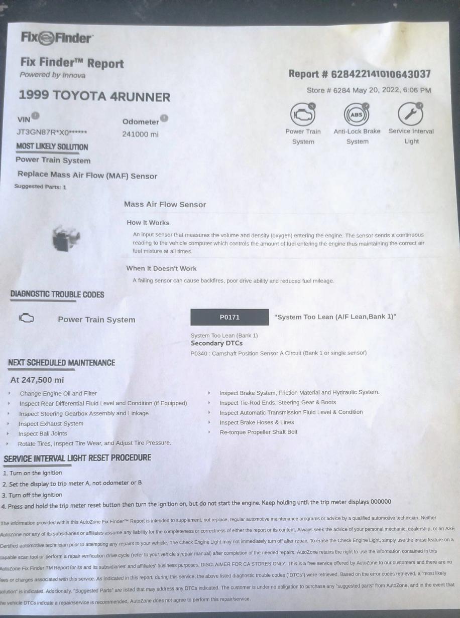

P0171 System Too Lean
Hey All,
My check engine light was on so I took it over to the local auto zone to use their scan tool. Code P0171 came up and it was suggested I replace my MAF sensor. I cleaned the MAF before a few times then decided to go to my local Toyota dealer and buy a new MAF. The check engine light turned off then after 16 miles turned back on. I've already checked for any abrasions bubbles or cuts on all rubber hoses and it all checks out, no leaks. any thoughts?

Hey All,
p0171 system too lean too much air not enough fuel. Check for vacuum leaks. dry, cracked hoses. Spray carb cleaner on the intake to see if there is a leak.
edit. pcv valve and hose are good.
Hey All,
Replace your primary oxygen sensor if you haven’t already, it’s a maintenance item anyway so even if it doesn’t fix the issue it isn’t expensive and can only help

Ill check that again. Any recommendations? I don't wanna take it in but I also don't have a propane torch. Will soapy water work?
Spray it with carb cleaner. Vacuum hoses won’t make any bubbles if you spray them with soapy water because they aren’t pressurized.
What [MENTION=319302]Bad Luck[/MENTION] said. you can buy cheap smoke machine of off Amazon etc or make one, there are you tube videos.
