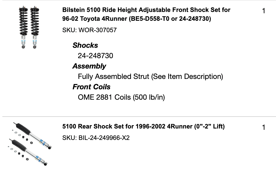

Guy I spoke with at Wheeler's told me 881s would be a better choice than 880s with 906s in the back. Do you agree?
881s and 906s and 5100s here. The basic Wheeler's-recommended noob package. Too bad I'm not qualified to provide analysis - I just drive the thing and am pleasantly surprised at its capabilities. Are you planning to use the OME springs with existing struts? I have a steel front bumper en route and am running heavy skids. I'm pretty sure I erred on the conservative side. We'll see how things hold up, but I wouldn't be surprised If I'm looking to upgrade travel/quality at some point in the future. 33s are next tires as well.
Edit - did anyone mention that OME springs for 3rd gens are side-specific? if you are buying used - caveat emptor.
...Are you planning to use the OME springs with existing struts?...
Plan was to get the 906s on and see what happens, maybe swapping the existing KYBs for 5100s or even 4600s. But with the 906s on the way I'm all amped up and about to pull the trigger on 5100s for the rear and assembled 881/5100 for the front from Wheeler's.
Are you running the longer 5100s in the rear? The 1.5" - 3" as opposed to 0 - 2". I've read that they're valved softer and that seems like something I'd like but who the hell knows until they're on.
Guess we can put a pin in this. The thought of only updating the rear coils was too much for me.
I ended up ordering the rest from Wheeler's. Went with the shorter 5100s in the rear to make sure those 906s don't have a chance of ever popping out. Totally going to be worth it. Right?

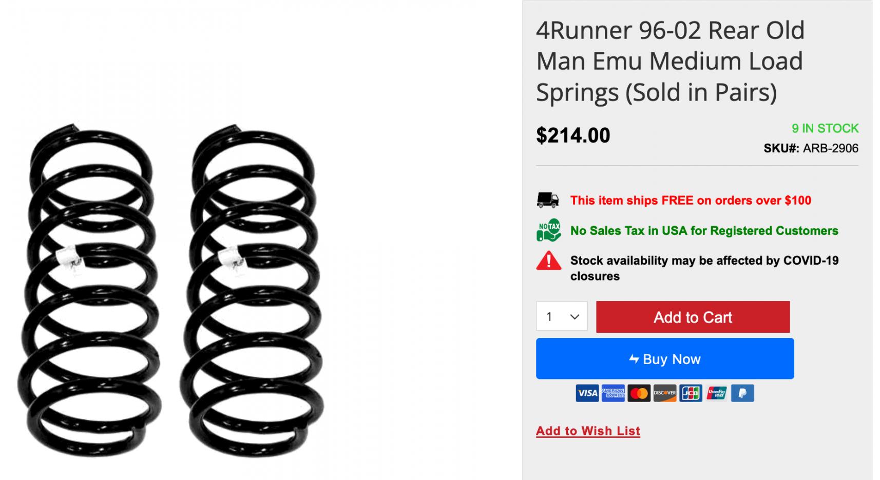

Okay, another dumb question. I picked up some OME 906s on Amazon. I was expecting to see a few of the top coils much closer together based on my understanding of progressive rate as well as all the images I've seen of them online.
While they're not labelled, one is at most 3/16" longer than the other. I was expecting a bigger difference, at least a solid 1/4" or 3/8".
Am I reading too much into this as usual or did I shoot myself in the foot trying to save some money?

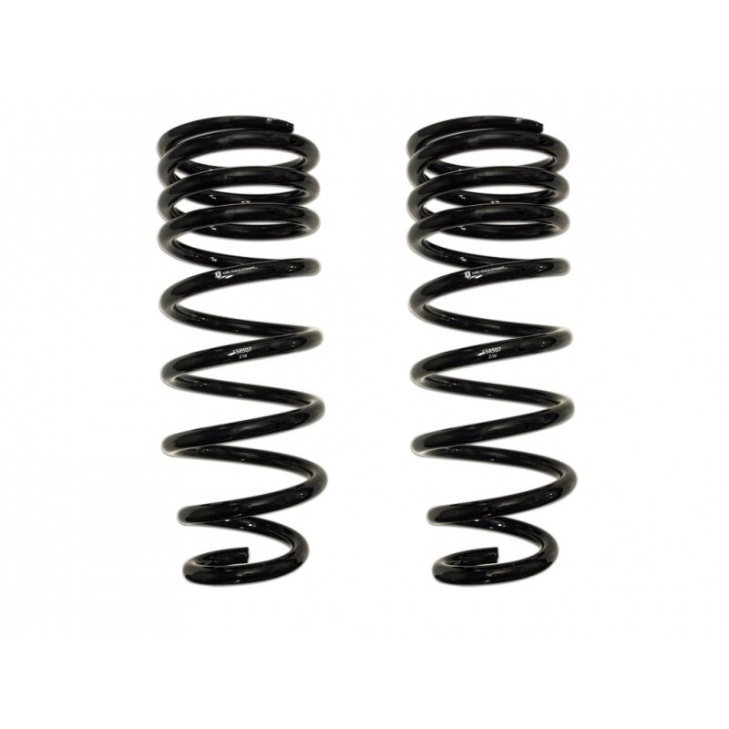

What I expected:
I know I led you down this track, so my bad. I ordered from the same folks but received the correct springs:
Looks like it's a hit or miss with these guys - the good news is that you should be able to return these as "inaccurate website description", since obviously it's a different spring than shown in photo.
I would hold out for the correct (progressive) version!
Not your bad at all but now I'm even more confused. I spoke with someone at Wheeler's and they told me "stock changes" and the coil spacing has "nothing to do with progressive rate". What in the world does that mean? I didn't realize 906s were even made in a non-progressive version. (image from Wheeler's site)
I'm returning what I received but who do I order from to get the correct coils?
It means you spoke to someone who doesn't know what they're talking about.
In fact, coil spacing is the only thing that determines spring rate in a coil spring with a constant coil and wire diameter.
That was the impression I got but I'm trying to be a nicer person in my old age, give people the benefit of the doubt!
Being a web developer, it really bothers me when images don't match products. Guess I'll order from Wheeler's and keep my fingers crossed. At least the 881/5100s for the front will be here tomorrow.
