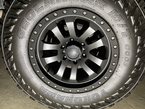

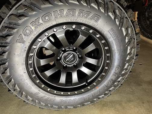

This may be an odd one. At least I'm having trouble finding related info. I recently bought a '99 4runner limited with a set of Pro Comp 17s. I wanted a full size spare, but couldnt find the exact same wheels. They seemed to have an updated, very similar design (same offset). I am wondering if there would be any issue rotating this tire with the original set. The tire tread depth is within 2-3/32s. Being a bit analytical, I weighed them and the new wheel design with tire mounted is 6-7 lbs heavier (approx. 102 vs 95). Could this cause any issues?
I included images of the wheels. The older design has the larger center cap.
