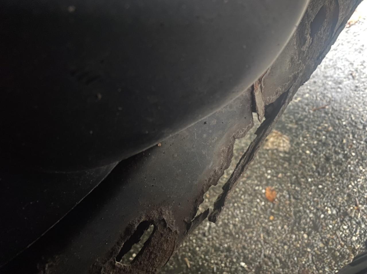

Just purchased a 2001 TFR SR5 sport. Super clean truck but have a giant spot on the frame that I need worked on. I’ve called every auto body shop in the area, no one will touch the truck. It’s rotted out about 10 inch section on the rear drivers side just before the axel. I have no welding experience. The last auto body guy told me to grab a welder from harbor freight lol. Anyone out there in Ohio that works on these? I love this truck want to make it safe! Thanks!

That's not an easy project for a first time welder with hobby welding gear. The damage is extensive.
You are going to want to cut that entire section of the frame out and weld a donor section in, which is not a shade tree project. You'd be better off with a frame swap.

It’s not a troll post, yeah I knew about it before, I paid 1500 for the car so it was understood. I’ve just seen a lot of other 4 runners online that have been repaired with less damage. I bought a pre fab piece from a website that is going to try and get someone to weld on for me, appreciate the info though.

The reason no professional will touch it is because you can't safely patch a single spot when everything around it looks like that - it's a potential time bomb

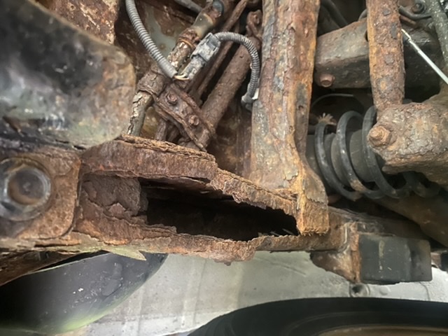

Here’s the view from the wheel well. So your saying even if I grind it down on this side, put a prefab piece on, none of it will be good? I appreciate the reply and feedback. Honestly just bought it thinking I could get someone to easily repair this piece. The rest of the frame is really good shape. I will look into trying to see if I can get that section of frame from another 4 runner. Thanks

I'm in the frame-swap camp. You still need specialty tools to make it happen quickly (like, a lift), but you will be MUCH more likely to find help in doing this because it's not a massive liability.
On the other hand, there's no time like the present to learn welding. MIG is pretty simple to pick up and anything you do now, if it doesn't past muster tomorrow, can be redone. I suspect that trying to find clean metal to weld to is going to be the major struggle... and doing that while on your back under the vehicle... lets just say I'm glad it's you and not me.

For $1,500 it's a parts truck with a rotten frame that's super risky to drive. If all of the major components are in good shape, including the interior, you can easily make your money back parting it out or swapping those parts over to another vehicle that needs what you have.

I personally have fixed worse. That is right near the rear arch and how I would fix that is to super clean out that inside frame. I would cut weld holes in the side of the frames and I would weld 1/8 plate on both the sides of the inside of the frame. then weld a new bottom on the rail.
These weld holes are very important and I mostly do it with a plasma cutter. You can do it with cutting wheels as I have done that before.
I even have drilled holes and bolted the plates in place to hold them firmly against the inner frame wells.. Then after I get them welded in then weld the holes shut .
Then I would use any anti rust solutions paint etc over the welds as they will rust extremely quickly from the heating up of the metal.
You can see how I have done some of these fixes in my build thread as I am known for rebuilding rotted out frames for the DIY on the 3rd gens in the rust belt.
I believe in welding the plates on the inside of the frames. So basically, you have 3 pieces of new steel making a U inside your frame with new metal if you are understanding my method.

Thanks so much, it helps to hear some encouragement, have you ever used the Safe T Cap system? It’s a pre fab cap you put over the frame. I really hope I can save the truck it’s so fun to drive :). Again thanks for the advice!
Yes. I have seen the safe T Cap system. They don't believe in cleaning out the frames which is how these frames rot out. So if you don't do anything inside the frame... Its still rotting from the inside out.
Thus why I suggest cleaning the frame out. With your frame bottom completely rotted most junk fell out.
So if you wish to go with a safe T cap system. You can just clean out and coat the inside of the frame then weld the safe T Cap over that.
I just suggested how i do it. I can always replace a frame body mount. As I have good metal inside to weld to.
You are going to have several areas that are really thin on this 4 runner frame. So the cleaner you can get the inside of the frame with good anti rust solutions on that steel on the inside.. The slower it will rot from the inside out.
So whatever works for you is whats best for your rig.. :-)
The Safe-T-Cap system is something fast and easy to produce once the dies have been made. It may also not fully address the rust area (meaning, you might not get to the point of having clean metal to weld it to). Such is the way with "one size fits most" applications. For the right situation, it's perfectly fine... I'm just not certain that yours is the right situation.
No reason it can't be used, but you might Also have to do some internal bracing. You absolutely MUST do all the rust mitigation prep if you want this repair to last any length of time (no matter which repair method you choose... well, it'll be a lot less if you pick up a better frame, but then you have other work that needs be done).
