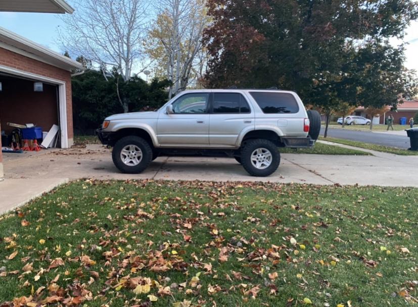

My spacers are 1.25”. Yours will be equivalent to stock wheels with 1.25” spacers with that backspacing. Here’s my rig with a 3”-3.5” rear lift and a 2” lift + a 1” BL with 32s. So essentially a 4” lift in the back and a 3” in the front.
