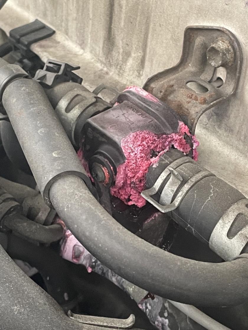

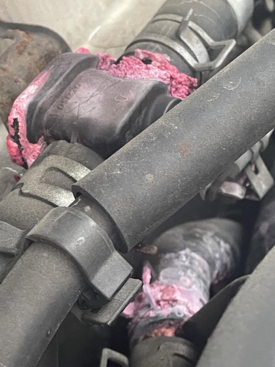

Heater Control Valve Gone Bad?
Any ideas what might be causing this? Someone told me they thought it might be a Heater Control Valve gone bad ...

[MENTION=95183]octanejunkie[/MENTION] might wanna chime in on this one.
Sent from my SM-S908U using Tapatalk
Like [MENTION=8262]badluck[/MENTION] said, that looks like a failed HCV with dried coolant caking all over it. Catastrophic failure is probably imminent...
