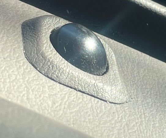

Can someone remind me of the purpose of the little bump on the driver's side of the dash where it meets the bottom of the windshield? A sensor of some kind? TY
