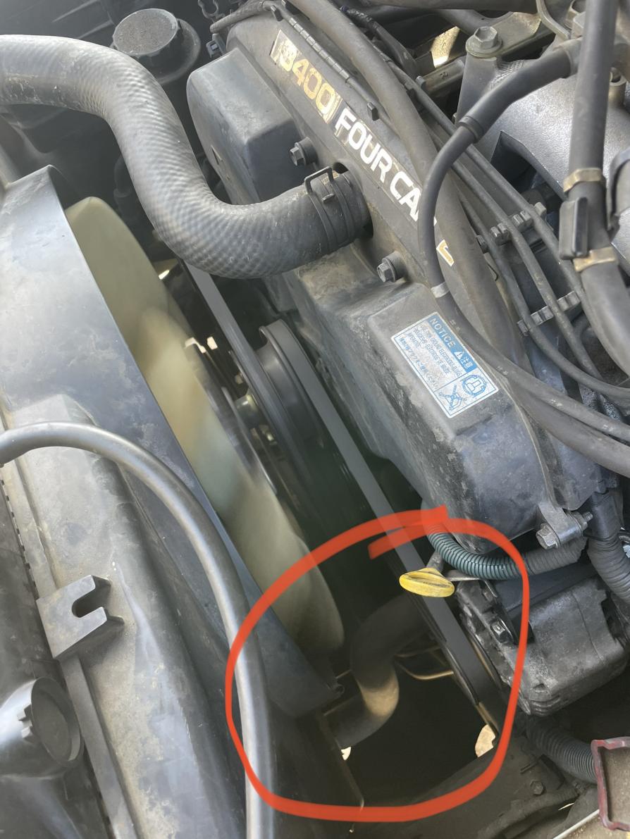

Is this the radiator out hose that the thermostat is attached to? Trying to figure out if it’s stuck in the on position. When I touch that house after the car is warmed up, it’s cold.
I think the problem with my heat is the thermostat because the in/out heater core hoses both get warm/hot (could probably use a flush but it’s not 100% clogged) and the coolant level in radiator is fine.
So if my thermostat needs replacing, does it make sense to replace radiator while I’m in there? Need a good video reference for changing out thermostat Timmy doesn’t have one.

Yes, that's the hose that the thermostat is connected to. It goes into the water pump. If you're replacing the radiator, you might as well replace the thermostat because you have to remove it anyways to get residual coolant out. So it makes sense. Get a new OEM thermostat and gasket if you do from Toyota.
You just need a 12mm socket and a 6" extension to remove the thermostat housing bolts. I've done it without draining the radiator, trying to save some coolant in the back country, but it's a mess, so remove the cap and drain it from the petcock. Jiggle valve at 6 O'Clock.

It's really not hard to do. I did it recently in mine. It's just three bolts, the hose comes off and the thermostat is right behind it; just need to pop it out and put the new one in. I did drain my radiator. I know you can do it without draining it but it makes a crappy mess. At least if you drain the radiator you can catch the coolant in a clean bucket and and then put it back in when you're done.
Found a video on how to replace the thermostat but it's Chinese! lol. At least it gives you a really good visual on what you need to do. Is your truck overheating?

That hose is attached to the thermostat, but it's the inlet hose for the thermostat. The upper hose shown in the picture is the outlet hose.
If you don't know when the radiator was replaced last I would recommend replacing it and the radiator cap. The transmission cooler in the radiator is known to fail and cause coolant and transmission fluid to mix and that will destroy the transmission unless caught quickly. $200-300 radiator is a lot cheaper than $3000+ transmission.
