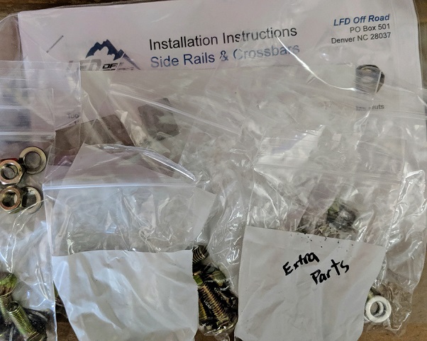

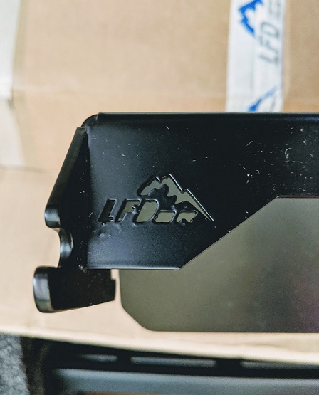

got mine a couple of weeks ago. just waiting for the weather and schedule to cooperate for the install. It took 20 days from order to shipment. Well worth the wait. Great customer service as well.
