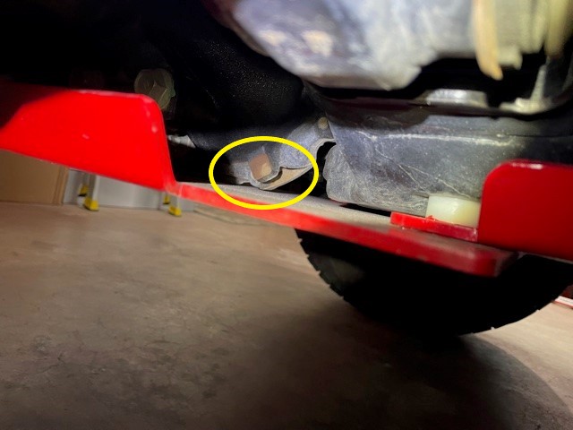

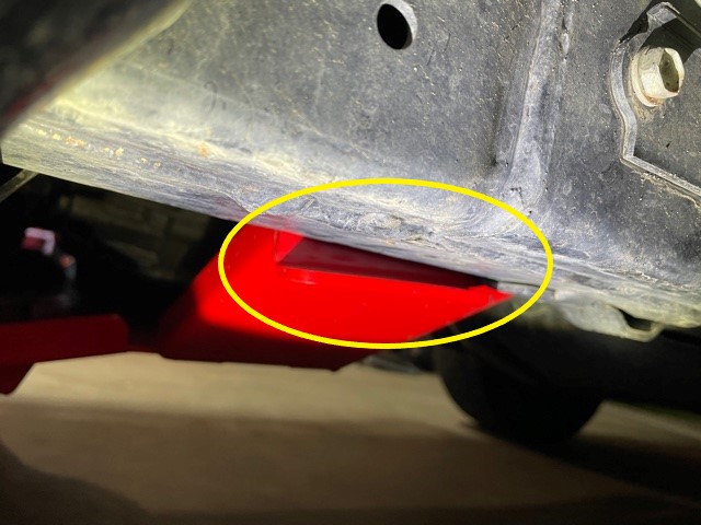

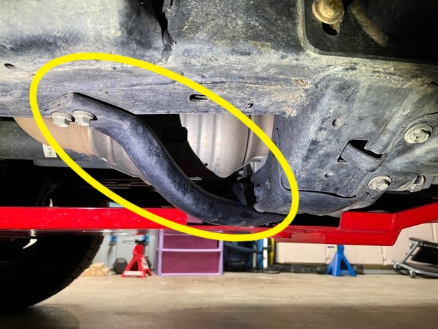

I installed my LFD skids and they did not come with any instructions, which was not really an issue, but i have a few questions.
Where the transmission skid and transfer case skid connect, there is that frame support bar, was i supposed to remove that and bolt the skids directly to the frame? See Pic 1 for better idea of what I am talking about.
Second question. I installed a diff drop and I just noticed the bottom of the diff is touching the front skid (See pic 2). Is this an issue?
Finally, the transfer case skid has that tab the sits under the frame. I know from other posts that it is not going to sit flush. Is the gap supposed to be this big (see pic 3)?
Appreciate the help and insight!

#1: no you can keep those
#2: for safety I added aluminum spacers to give some clearance
#3: not sure sorry I don't have that
Did you add the spacers on the four bolt holes for the front skid?
Appreciate your help!
I have a TRD skid plate but I'm sure it applies to LFD as well, but yes all 4 because you want to keep the same distance at each corner otherwise you might screw the skid plate in crooked and damage the thread in the frame.

Frame supports stay on.
I also have a diff drop but don’t think it makes contact like that. I’ll double check when my wife gets back from work with the 4R.
Gap between the tabs and frame can probably vary to some degree. As long as it’s how LFD designed it, as I’ve read, I wouldn’t worry about it. Mine was a PITA to get on and off.
I wish I could be of more help, but I don't have the diff drop as I am at the edge of my lift height where I was told it wasn't necessary.
As for the cross member supports in the back, I left them in place and bolted my skid plates on top (er... underneath?) those.
