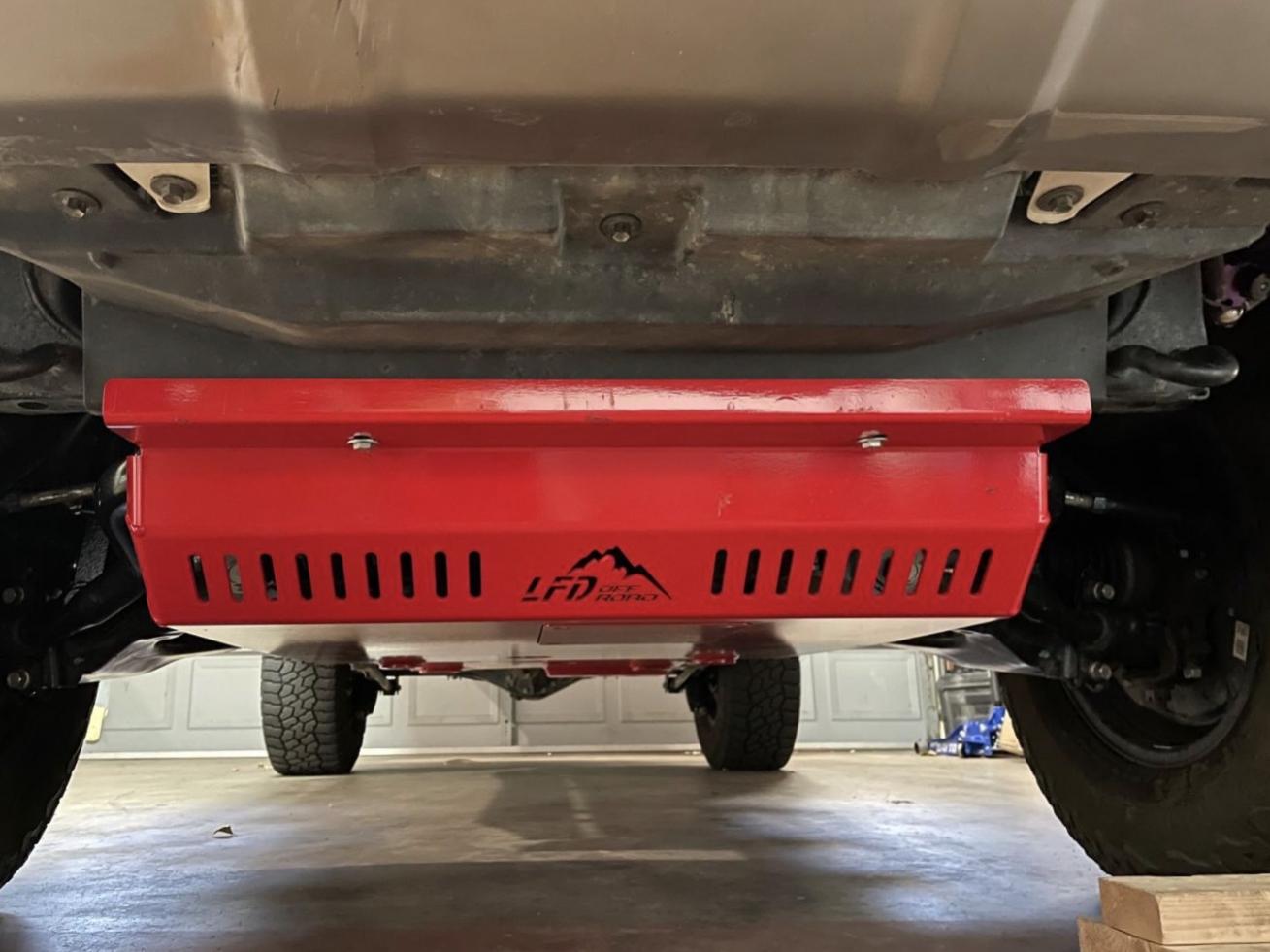

I tucked the splash guard under the lip of the skid and it fits perfectly. Looks way better too! Too bad I cant get my picture to be right side up.
Fixed it for you. The skid looks much better.

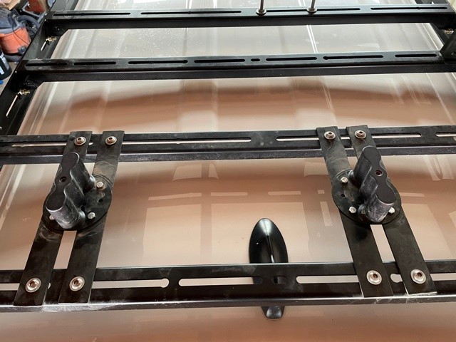

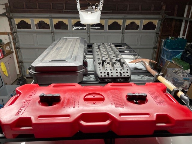

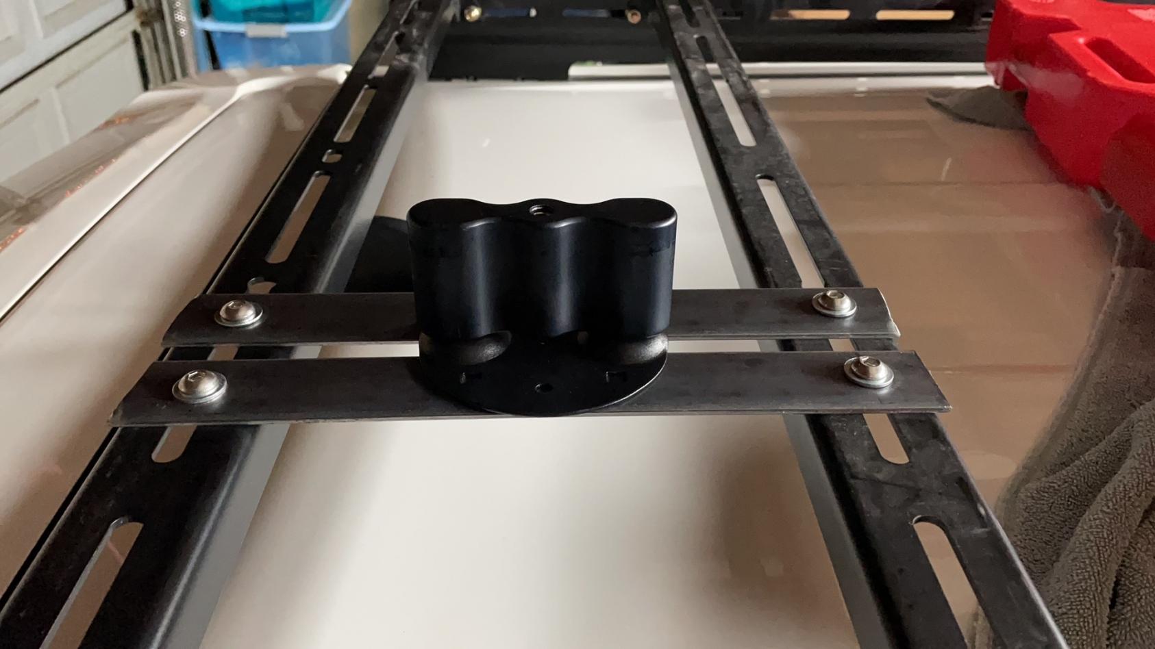

This was a challenge without the accessory mount sold from LFD. I am someone who does not like to spend money when I can make my own version, so that is what I did. This process did take two crossbars. I have a 4gal Rotopax that requires two mounts.
I bought one metal flat bar from HD (1" x 72" x 1/8" thick) and cut them down to four 1ft pieces. I then measured to find the middle of the bar and marked drill holes for where I would mount the rotopax mount to. I also measure 1" from the end on each side for holes to mount to the LFD crossbars. I then spray painted them black and mounted.
They worked really really well and it only cost me $12 for the flat bar (I already had paint and mounting hardware) and maybe 2 hours of time. It is so solid that I can use the Rotopax handle to pull myself up from the ground.
