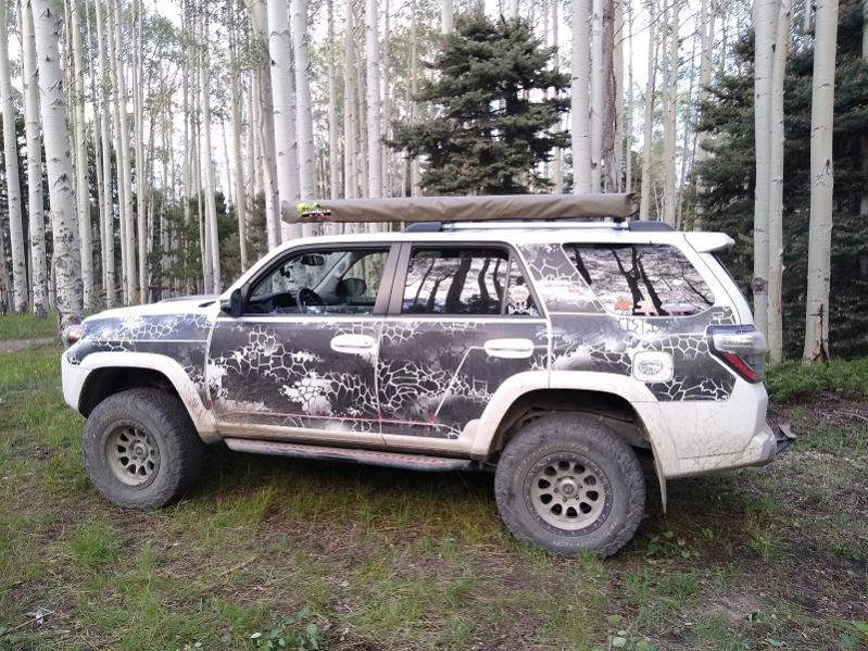

I have the Ironman 2.5m awning on stock rails with LFD crossbars. No issues, other than a slight bounce on rough 4x4 roads. Never caused any problems though. The quick release brackets are amazing, takes 15 seconds to take it off and store it in the garage.

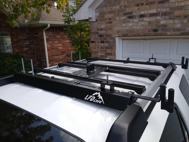

Thanks for the feedback, can you post some pictures of the brackets and how did you mount them to the crossbars?

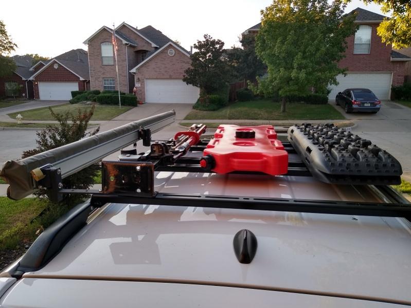

The one thing I had to do is to make the two holes I used for the L bracket that came with the awning bigger (to fit the LFD hardware). I think it was 5/16 if I remember right. Steel was hard so it took a while to make the hole bigger. I mounted it with the outermost 2 holes so that the awning was out as far as possible. The awning then just sits on top. The back is secured by a Brinks lock I got at Wal Mart and the front is secured with what came with the quick release awning, a pin. You can put a second quick release bracket on the passenger side if you want and it is easy to move from driver to passenger, but the awning will stick out in the back (because of the 3/4 roof rack). To solve that you would have to add a 3rd quick release on the awning itself (not on the mounting brackets, just the awning). I plan on doing that but I haven't yet. I still don't know if it would work or not. I may have to put 2 quick releases on the awning as I doubt the middle one is exactly half way.
I also have the tent that goes with the awning. It is pretty cool, but heavy and bulky. I have used it and put an XL cot inside and fit perfectly.

Do you worry about the HiLift rusting and staining the paint. It did on my xterra.
