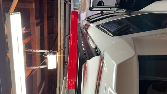

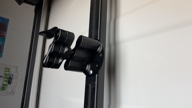

Mounting diagonally will make your rotopax sit diagonally as well. Ask me how I know LOL
I would assume you could go without the plate, I just do not know how sturdy it would be with only two bolts. Also, the Rotopax would rub in the crossbars and may rattle and cause wear on the outside of the Rotopax where it is touching the crossbar.
Good point, I haven't thought about that! :loco:
Should be fine mounted directly to the crossbar with only two bolts. Note that the mount is installed to the plate with only two bolts, so at some point they determined two bolts was good enough. The 4 bolts used from the plate to the crossbar is actually overkill from that point of view.
I think another use for the plate is to allow multiple ways to mount the Rotopax. Without the plate, and normal cross bars, you can only mount the Rotopax in the vertical position.
I am sure two bolts is enough for the smaller 1gal or 2gal Rotopax, but for me, I did not feel safe with the 4gal and only 2 bolts holding he mounts onto the crossbars.

So I was looking at the actual rotopax mount:
I was wondering if it's possible to mount just the mount itself (top left in the picture above) without the round base.
Or maybe mount the round base diagonally?
Quick follow up on this, I was looking at the rotopax website and found this in the mount page:
Use with included base plate or remove plate to attach mount direct by bolting up through the bottom or down through the top.
So both should be safe.

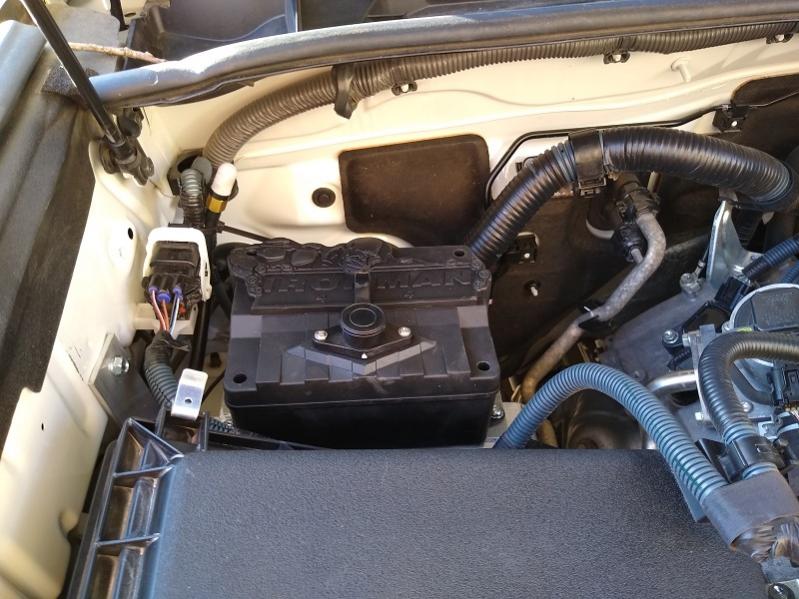

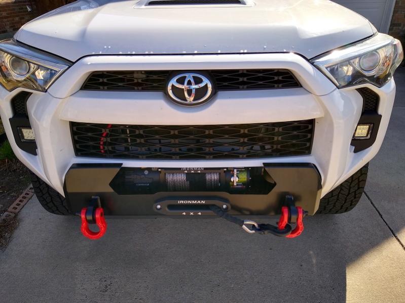

Well I finally got my LFD Hybrid bumper and winch installed. It was a beating, mainly because I decided to mount my control box up by the airbox as someone on YouTube suggested. I had to buy some new longer cables and do some wiring inside the control box. Somehow I did it right and am happy with the configuration although I guess I won't be buying a second battery anytime soon. :-)
So the questions are, where are people mounting the front license plate?
The hook I got on the Ironman winch isn't big enough to fit around the D-links I have. Is Factor 55 Pro and Flatlink what most people use or is there a cheaper option that still is good quality?
Lastly, I noticed on some other hybrid bumpers there was some flat steel that attached to each side of the bumper where you could then stabilize the factory plastic bumper on each side which the LFD bumper doesn't have. Anybody have any issues with the plastic stock bumper flapping around at all?
All in all though, I love it. Just what I wanted, spool and clutch access.
Congrats on your purchase.
I went with the Rough Country Winch License Plate Bracket Kit | Hawse Fairlead | RS138. You can get it on Amazon for $20. It works great but hangs a bit low. If I leave the plate on it gets bent flat in the rocks. So I used wing nuts and usually remember to take the plate off when I hook up the winch controller. You can see it sticking out of the hawse below.
I wanted a factor 55 thimble or something like that, but they cost way too much so I stuck with the hook that was included. It latches and fits on my shackle.
I know what you mean about the "flappy" bumper ends. I thought about some simple strap to tie those in, but never did. I've had the bumper over a year and haven't had any issues. And yes, I've run the bumper into water, mud, a tree, ...
Cool on the license plate holder. I was barely able to get the fairlead on as the bolt was barely long enough to fit the flat washer and lock washer on. Maybe the lock washer will be smashed down a bit so I can fit the license plate holder on it. If not I'll have to get rid of the lock washer and hope it stays on.
Good to know about the floppy bumper. There is one place where I can put a zip tie from the bumper to a hook (I think the tie down hook) but I may just leave it and see what happens.
Take the bolt over to your local small family owned hardware store and get the next sized longer one. I had to do that with my Warn Winch & Bumper.

It comes with longer bolts - M12-1.75 x 35mm - and you reuse the nut and washers from the winch kit.
