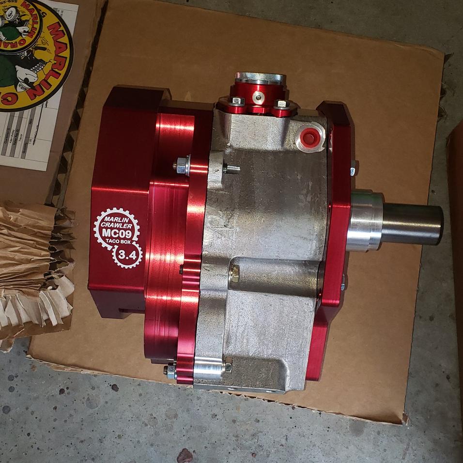

After 6 months almost to the day, its finally here.

That's one hell of a lead time. I need an adapter for mine because it's for an auto and mine is a manual. Scared to call and order.
I always prefer to run Marlin but I have to say my Trail-Gear Adapter is well built and has held up well. and I had it a week after I ordered it. Just saying.
Shiny. Gotta love Marlin. When I called they couldn't even give me an estimate when they'd have them in. Something about there fabricator not being able to keep up. Get another fab shop involved. lol
Just a thought but can you just switch the tail housing to an auto housing?
Yep. TG is holding up fine here as well. It's the go to company for impatient folks like us. lol
