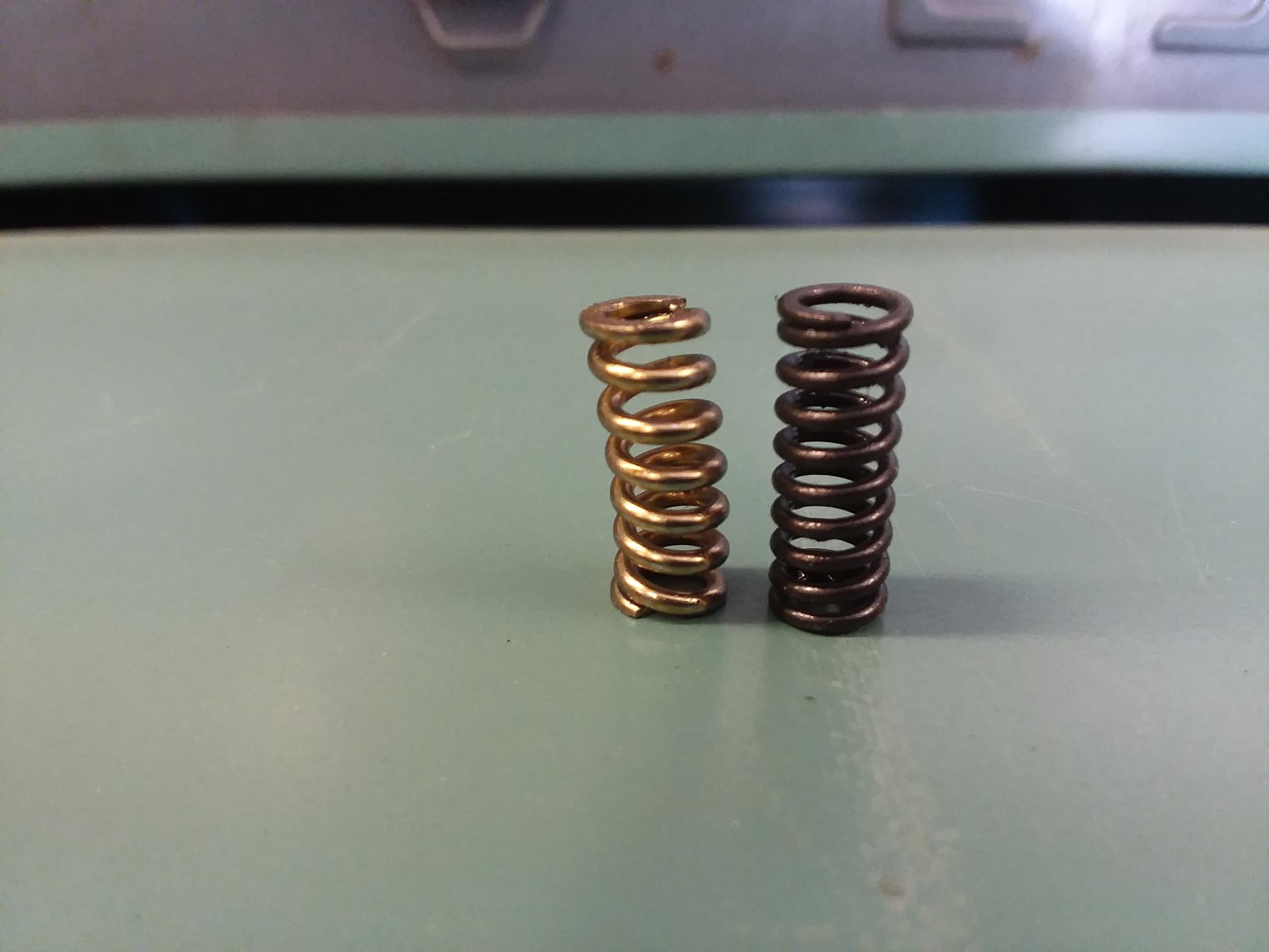

I wanted to clarify for people reading up on dual cases down the road, my issue with my TG case popping out of gear when going down hill while using said to slow descent and not the brakes, is not "normal" and TG was not the ones who said they thought it was. I first talked to LowRange as that is who i purchased the unit through, and was told this by one of their sales people this but they would look into said... When I asked about my issue on the forum I was checking if anyone else was/had this issue with there TG unit as the notion the jumping out of gear was norm or i had to build a system to hold it into gear is bs. I talked with TG directly and was told my unit was built with a oem spring that rkntoy posted and they would send me the heavy duty spring rkntoy linked. Just wanted to make it clear that if u get a TG unit is not build with the idea that u'll have to live with a case that will jump into neutral while descending geared down, with that said u'd think they would just put a $4 spring into a 4.7 gear case to start...

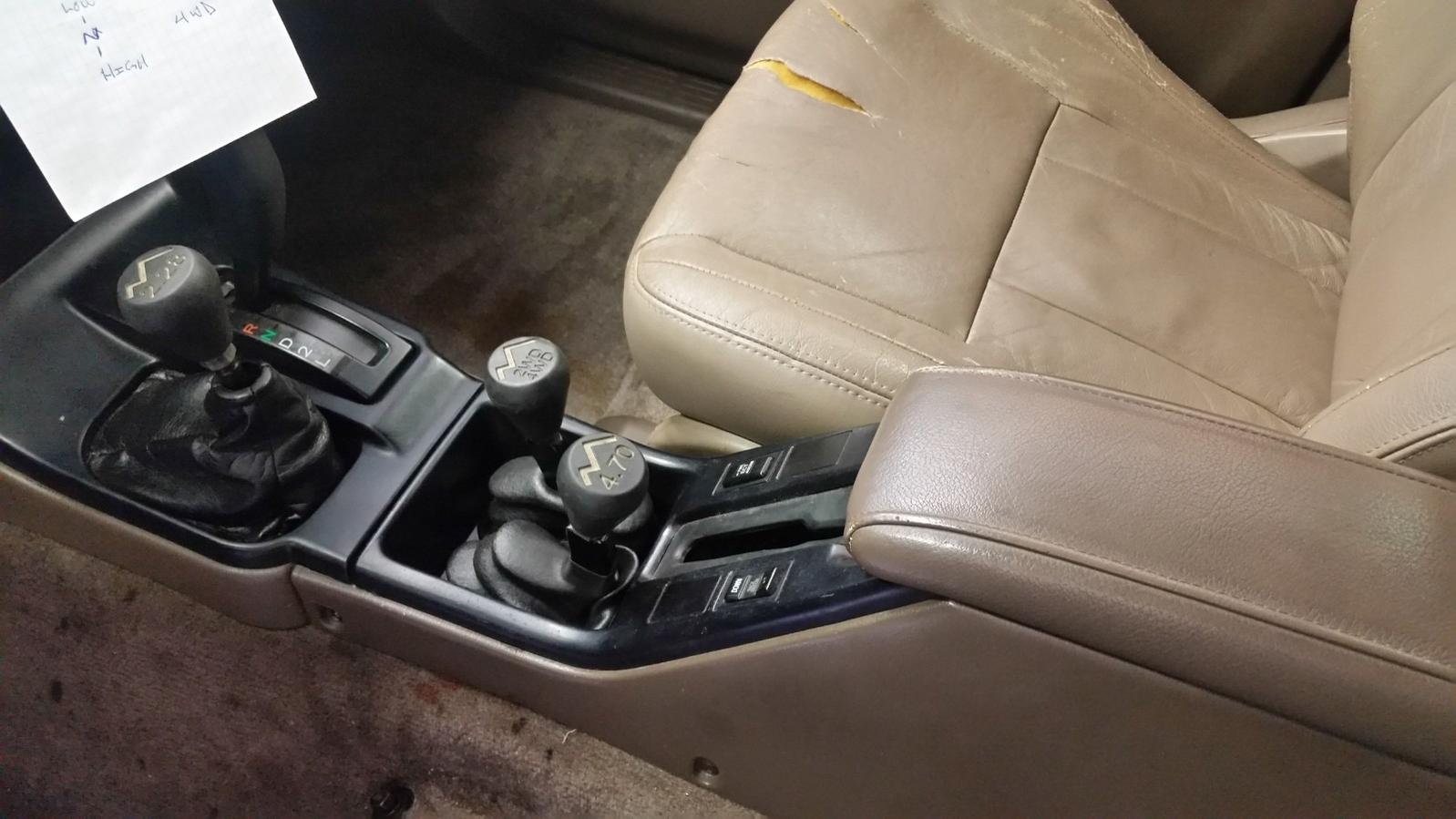

Triple stick is nice but is really a personal choice on how bad you want to keep your interior looking stock or how bad you want to keep your rear cup holder in the center console? For me it was worth it and I am very happy with how it turned out.
from this
Smokey 12 by Sam Wright, on Flickr
To This :)
Dual Case 11 by Sam Wright, on Flickr

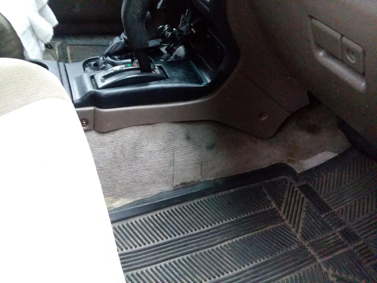

Went with the stock look, stock case shift set up like AxleIke, for the front made a hidden shift point that I can add and remove the shift handle as needed. 20180826_191259.jpg

just like the person in snow junks link, the HD spring didn't change anything 4 me, still popping out of low downhill...

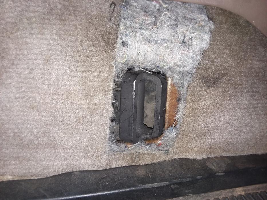

Even though mine is staying in now, I clearanced around the shifter some more as the boot/shifter was still getting some pressure on it when it was in low.

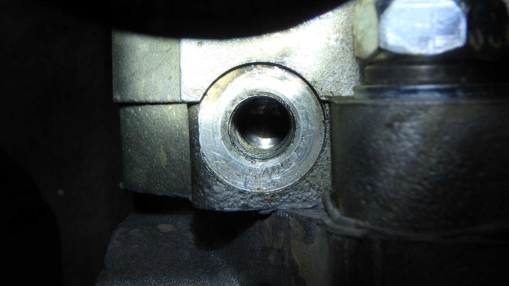

Not a clearance issue, I ran it with the shiftier removed from the unit (I can look into the case) and it's popping, it's internal. I pulled the HD spring back out to check the ball, the HD spring is bent/twisted, it was in 4 less then and hr...20180919_121450[1].jpg

Weird. I can't think of what would make it bend like that. It should sit in its little pocket and push on the ball.

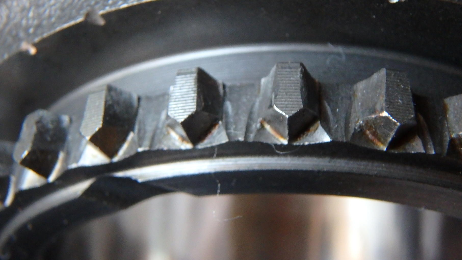

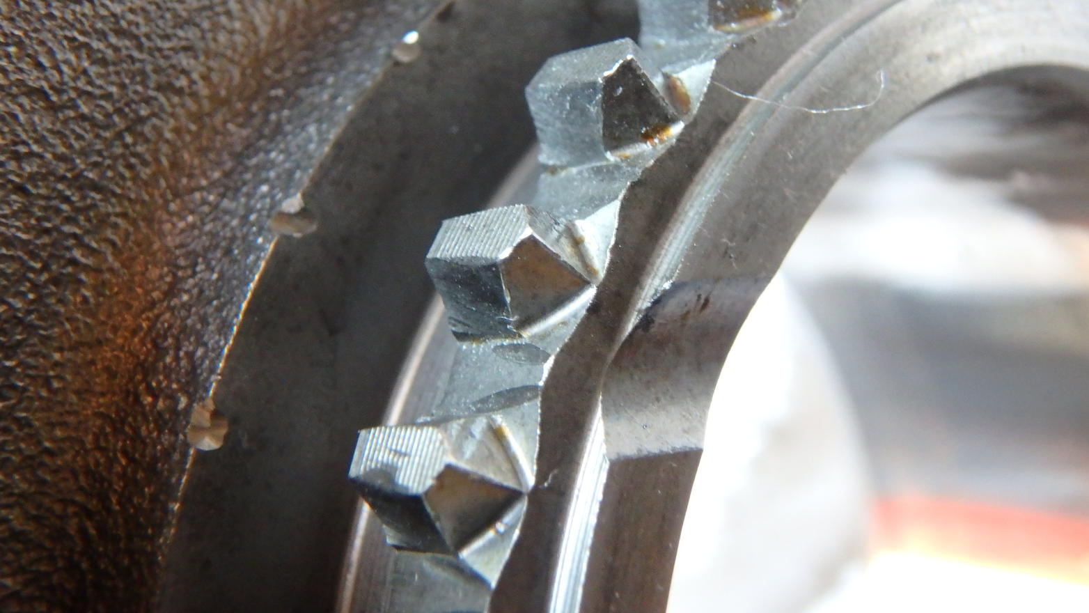

My T-case is no longer popping out of gear. The fix requires the complete removal and dismantlement of the case... Matt at Precision Standard Transmission in Colorado Springs is the one that resolved the popping by cutting slots into the new 4.7 gear so that shift collar and the gear can properly pull together under pressure as they r suppose to normally. I also replaced shift collar with one he had on hand that looked to have a little more bite (not to say that the one that came with the case wasn't in good shape or wouldn't have been fine) did so because I was already in there... I am using the stock shift spring and not the HD
