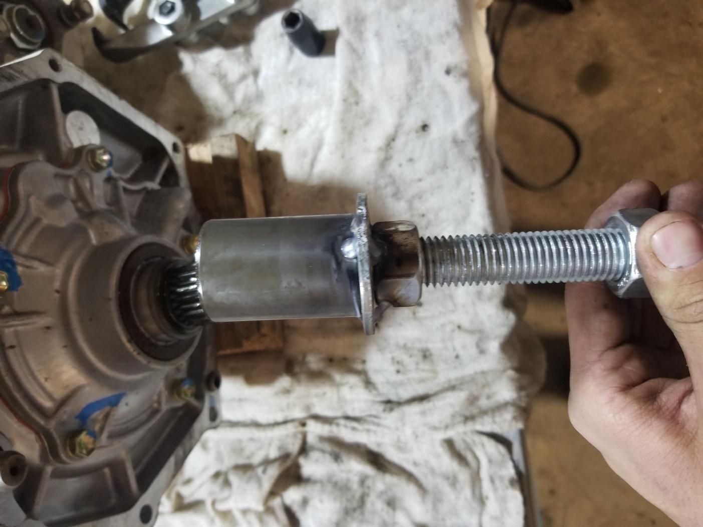

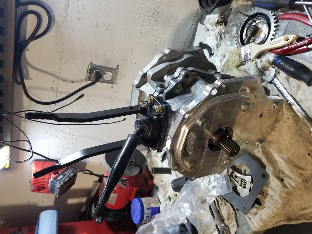

Reviving this tread. Currently putting dual cases in my 5spd swapped 97 limited 3.4l.
I'm using a top shift reduction box and rad design triple shifters. I already have the reduction box together and now I'm starting to pull the chain case. Does anyone have instructions on the trail gear kit? The given instructions is missing 35 to 39 and I have some bolts and nuts that don't seem to be getting used.
Anyone have pointers? I've searched and searched looked through so many threads. I'm sure I'll figure it out but I'm hoping there's some more info out there so I don't f it up
You can pull up the directions on their website. Just go to the product and there will be a tab to download the directions. The directions are really good at first, then tapper down but there enough info to figure it out.

That's part of the fun of doing duals. Instructions suck and you basically have to figure it out using brain power. Just use common sense and dry fit everything before committing to RTV. It's pretty straight forward.
One piece of info I wish I had for install was using Permatex Right Stuff to seal the coupler to the trans output shaft and crawl box input shaft. [MENTION=135317]rkntoy[/MENTION] gave me that tip after it was installed. lol I used grey RTV. I'm not having any issues with leaks yet but it seems a lot of folks have. Very few folks who've used the RIght Stuff have leak issues. YMMV.

Thanks for the tip! I have aviation gasket maker I'll throw on it won't go anywhere.
Ya I followed up untill it tapered down. I'm more than confident that I can figure it out but more directions would be better haha. She'll been in there soon enough!

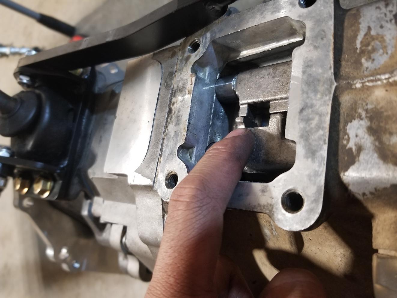

****ed up big time. Risked it for the biscuit and didn't get the biscuit.
Fully sealed up the rear tcase after cutting and removing the pin for the rad design. Driver side Doesn't shift all the way foward.... Forks supposed to be ground down as well :(
If you own a dremmel you can fix it without pulling the case apart. Just turn it on it's side and dremmel away. Here's the link to when I did mine. The third photo is what you want the shift rail to look like when you're done.

Honestly I was thinking that I have access to an air die grinder I was going to do that but hesitant. Guess I'll be going that! Haha Thanks for the reassurance!

I did the exact same when installing my 'duals'. I pulled it apart and ground the shift rail tho, I didn't feel comfortable grinding it in the case and getting metal 'dust' inside.
