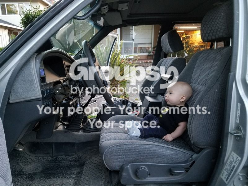

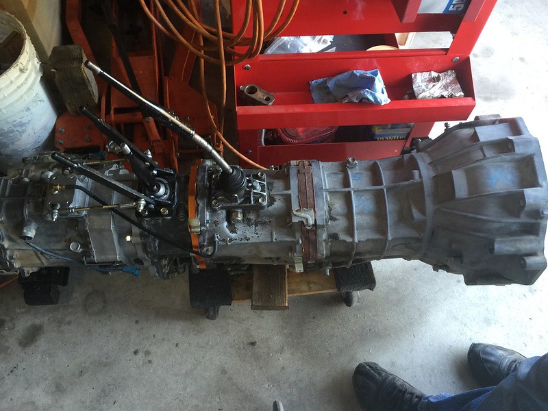

cup holder is one way but I used RaDesigns triple shifter. it allows you to not cut your floor up as much. Great product.
Triple stick setup by Sam Wright, on Flickr
Can you explain how the levers work with that setup? Does the factory lever still have its J pattern?
I'm probably going TG adapters also if I do this, so your box & adapters measurement would be appropriate for my driveshaft calculations.
So the Left lever is a hi/low for the rear (stock) Case.
the center lever is a hi/low for the front reduction box.
the right lever is the 2wd/4wd lever.
if you look at the pic of the transerfcases you can see that the center shifter is simply the top shift of the reduction box. the two outer are connected to a rod that actuates a lever at the back case to operate the hi/low and the 2wd/4wd. This brings up another issue that is exclusive to the triple stick set up. you have to remove the interlock pins so that the hi/low side can function apart from the 2wd/4wd. So no j-shift with triple sticks.

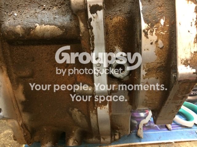

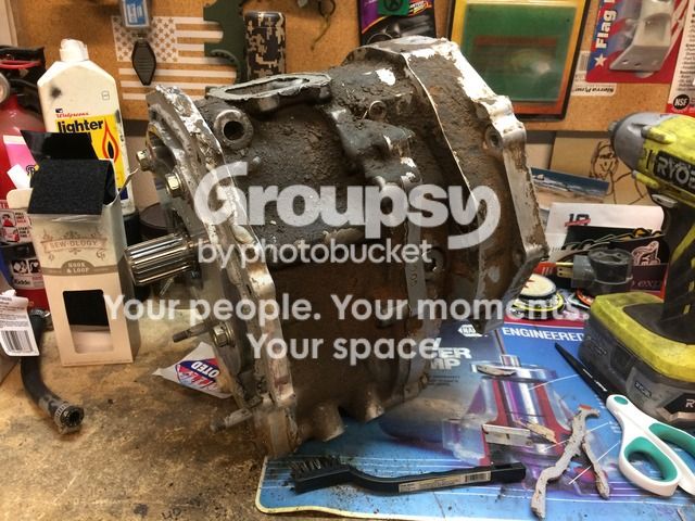

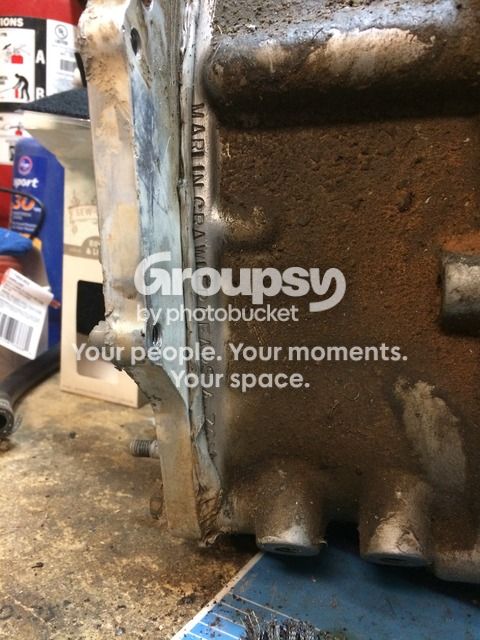

Awesome, just found this thread! I just dug out my Tacobox from under the workbench last week and started rebuilding it. I've got it all cleaned up and waiting for a bearing to come in before I put it back together. I have a short shifter for the rear case, but am going to order triple sticks from Radesigns for it. My wife hated not having that second cup holder in my Taco. Following this thread closely!
Cup holders are nice, My wife really agrees, and having the triple stick is great. I wish I had replaced the bearings in my crawl box while i had it apart. I get some growling if I short shift to soon on the street. next time it is out (hopefully no time soon) I will be putting new bearings in.

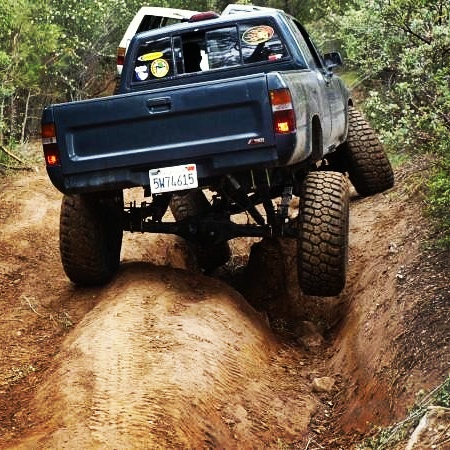

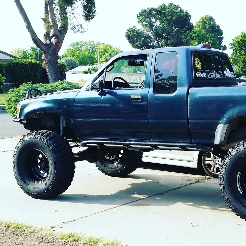

[MENTION=53470]Rockdawg84[/MENTION], I don't have a built thread due to others who have their own opinion. All my built even my 3gen pickup SAS I don't have one. People always have different way of building their shit. Some just have to stick their 2 cent in it. I rather not deal with it! But I'll keep update.on pics coming! Here a few of my truck sas, 37s, dual cases, 5.29, air lockers, blah blah. .lmao
