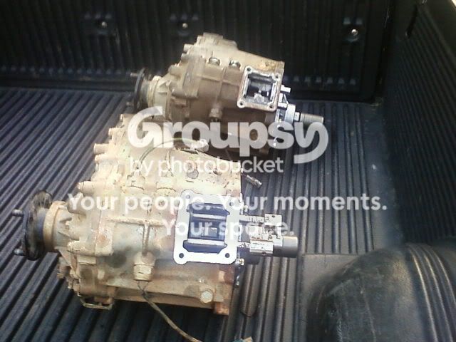

what's a reasonable price for a complete transfer case for this? (semi-local guy has one)
I don't know about your area but here in Arizona I have seen them from $150 and up, I wouldn't pay more than $200 because you can get a brand new heavy duty box from Advanced Adapters for like $199. What is he asking? Remember, I would encourage you to put a set of bearings in the case since the old ones are probably 30 + years old and usually abused as in never having the oil changed etc, and since you have to buy a 23 spline gear in it you are really just paying for the case, and some bearing retainers, syncro hubs and shift forks. The syncro hubs will be the hardest to get.

It doesn't; it is a stock case that comes with this additional 4.7 gearset
So, I'm hearing that the gearset in question cannot be converted to 23 spline, correct? (judging by the photo, I'd've assumed that I could just buy the correct shaft from TG...)
Correct that Gear set won't work for you. If he will sell the case without the gearset for a good price then grab it Also make sure it is a top shift and not a forward shift case. A forward shift case will have shift forks sticking out of the front of the case Top shift will not.
cool. moving forward on case only. thx.
I'd hit car-part.com and search for an 85 4Runner tcase. I picked mine up for $50 and all you really need is the shifter and case itself because a 4.7 gear set comes with new bearings and you ditch the 4x4 section.
