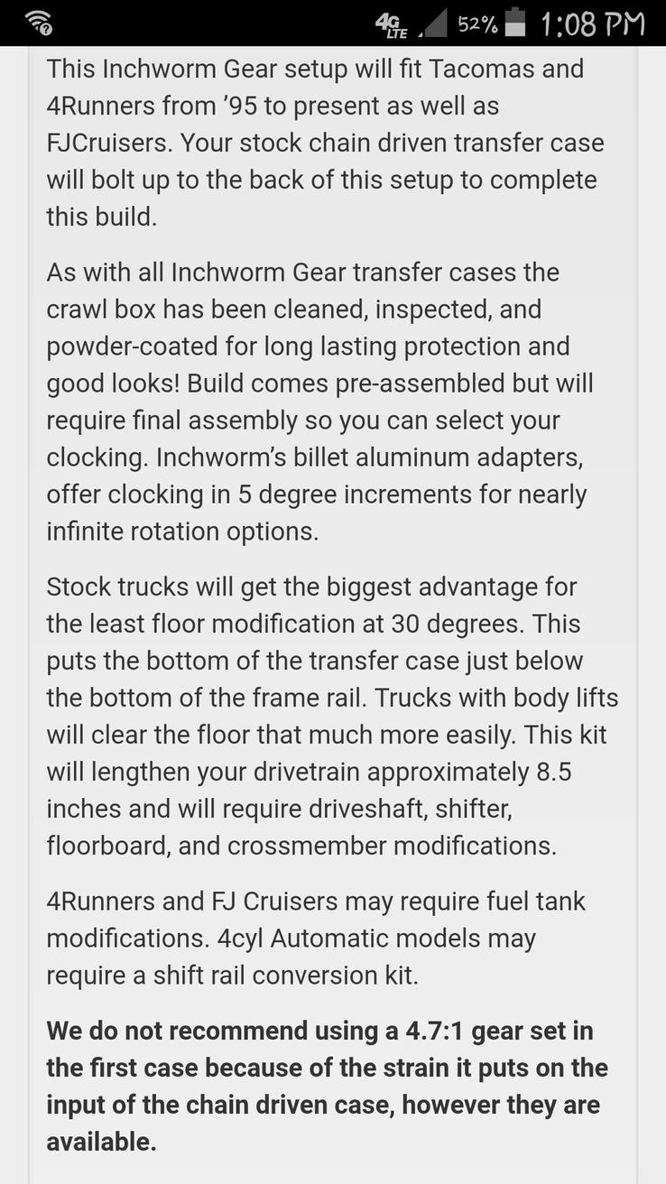

Anyone have problem running 4.7 up front with chain case? I run 4.7 in the rear of my crawler no problem. But inchworm doesn't recommend jw? Just thoughs
4.7 in front of the stock chain chase is essentially the "Tacobox". It's pretty well proven to work.
The Inchworm recommendation has to do with running two gear driven cases.....you don't want the 4.7 in the front case in that instance. ***EDIT*** And apparently it's not recommended in front of a chain driven case either. See Jaysen's post below.****
I don't doubt you on that either. But inchworm post this on their site.
Lowrange Offroad had/has (can't find it now) an article on it....they (are partners with Inchworm) said it's proven itself to be fine.
Let me see if I can find it....Well, I stand corrected.
I can't seem to find it anywhere. Thought it might be in my email list since they send out a newsletter, but that goes to my junk folder and only goes back to Dec. 27th.
Best thing to do, IMO....is call Lowrange and ask their reasoning. If you don't mind letting us know what you find out, I'd appreciate it as not being able to find the article is driving me crazy. (I know, short trip, lol).
Funny I just remember one of Marlin old friend 86 2gen turbo pickup ran a 4.7 front case with a 2.28 rear case for years without problems. Maybe it's a miss understanding somewhere..
