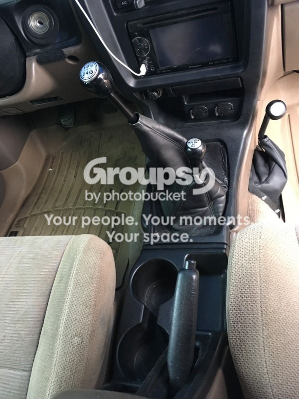

Rockdawg, I have a couple of questions. Where did you get this shifter 'boot'? Custom?
I have a URD short shifter kit (on tranny), and am installing Radesigns triple sticks, like you have done. Do I have to remove the interlock pin for triple sticks to work properly? Any tricks / tips I should do or be aware of for the triple sticks?
Lastly, did you have to extend your 'speed sensor'? If so, can you describe how you did it? It seems like it would be simple, but I want to make sure before I 'hack' into factory wiring.
thanks
Durwin

Durwin,
happy to answer as best I can. Yes my boot was custom made by a local auto upholstery shop. I took my factory boot in along with the rubber boot from RaDesigns and said I need this to look like this. He said no problem and I picked up the new boot a week later. A couple of things I wish I had thought of when I had him make the boot, I wish I had told him I needed some extra room because of the taco plate moved the front case back almost an inch and it has a tendency to pull away from the frame when I shift into double low. I think I can work it out but haven't taken the time to pull it off and work on it.
On the interlock pin. yes Rory has in his directions that the interlock pin needs to be removed for the triple stick to work properly. If you think about it the interlock pin keeps the 4x4 and hi-low rails for being shifted independently, in other words you can't shift into low unless you are in 4x4. But the triple stick allows you to be in low and with a front case double low 2x4. So yes make sure you remove that pin.
I did have to extend the speed sensor wires. If I remember correctly I simply butt spliced in a longer section of wire. easy peazy. Just remember to use some heat shrink tube to seal the splices so the weather doesn't get in there and cause corrosion.

Rockdawg, thanks for the quick reply. A couple of follow up questions.
Did you install the rubber boot that came with triple sticks, under the custom boot? The stock tranny and tcase have rubber boots, under the faux leather boot. Did you keep or eliminate this part? I hope you understand what I'm trying to ask.
Ok, I read those instructions 3 times, finally called Rory, and he said not to bother because it's a pain to remove...this is why I'm confused. What your saying makes sense. I think Rory must have misunderstood my question, or application. What is the simpliest way to remove the interlock pin? And do I have to 'grind' the foot off the high / low shift rail?
I figured it was just a matter of splicing in a longer wire, but it seems the mods, that appear easy are the ones that give me the most headaches, if I don't ask the 'dumb' questions before I start.

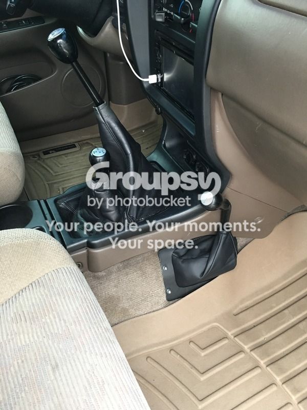

Dual cases:
I first just lost a cup holder like is common, but that was annoying, so I fabbed up linkages and kept it all stock-ish. Someone talked about stock early on in this thread, so that was a common element for me. Used a factory automatic boot and boot cover, and just bent some 1/2 solid bar in my press brake to make the handle curve up and over for the front case. Still needs stickers to get the high low pattern correct.
Basically, loads of work to satisfy OCD tendencies.

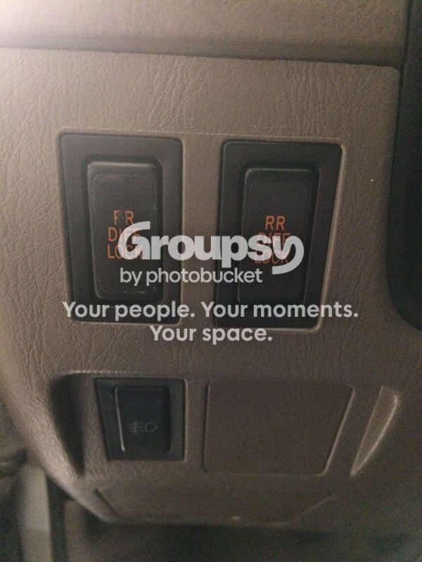

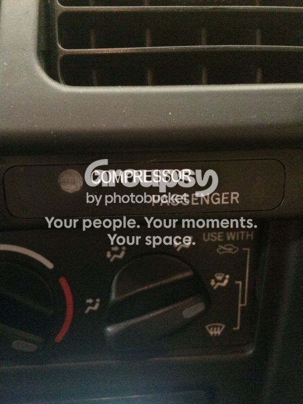

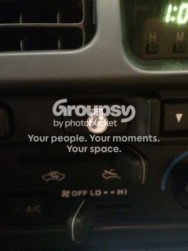

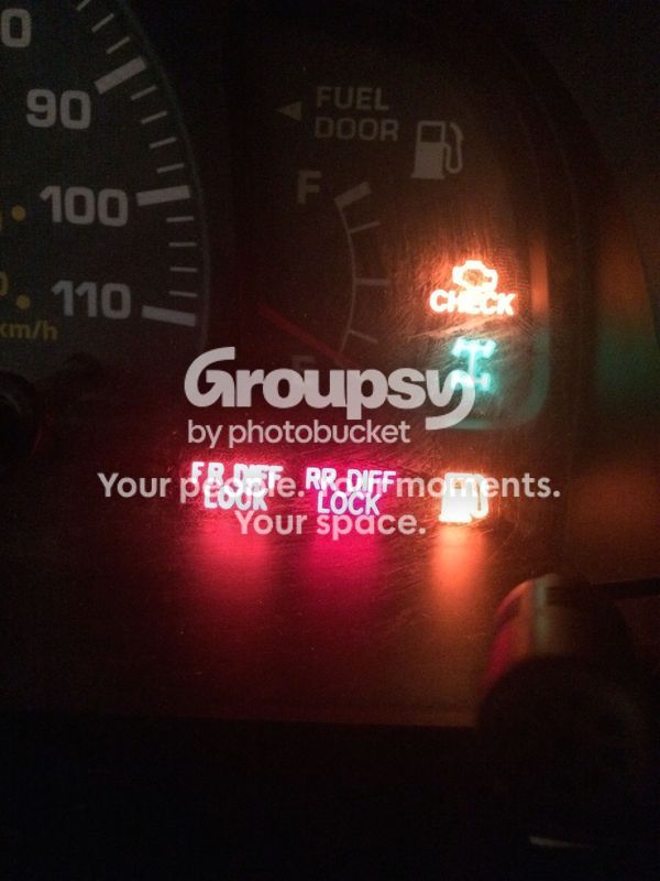

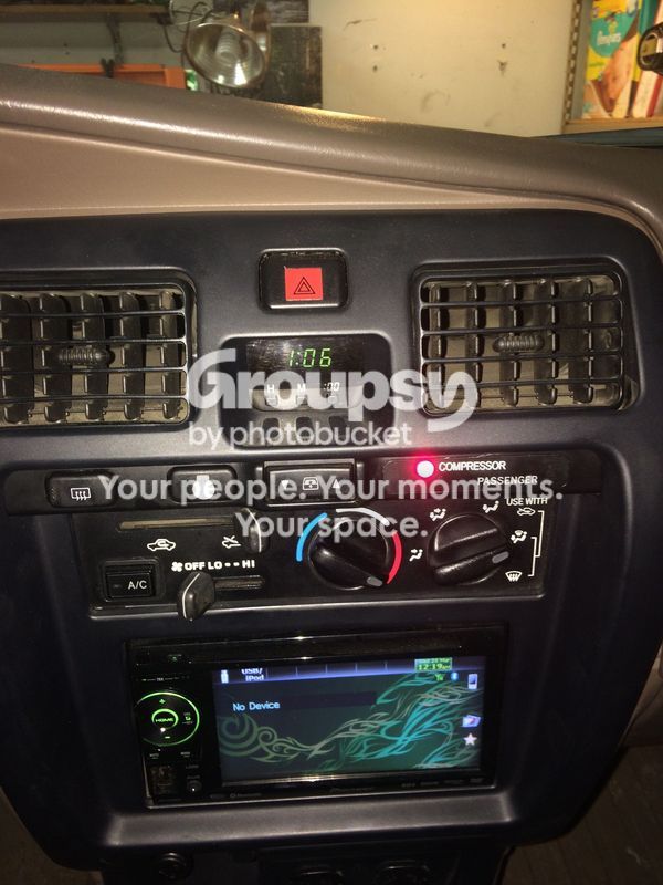

For lockers, I'm not a fan of carling switches, so I again did the idiotically difficult method and wired everything up all stock like. Spent several hours in the back of the local dealership with wiring books and found all of the pin leads to wire everything up using factory plugs in the dash, so it wasn't a cut and paste job.
I got an automatic switch board from the junk yard, and wired up the ECT switch to the compressor and had a little decal made from the ARB compressor switch.
Used the security LED as an indicator:
On:
Followed someone elses lead on the webs and cut and pasted a modified taco screen print into the dash, but its wired in using the factory plugs on the back of the combo meter, so the bulb is factory and there are no extra solder points on the combo meter itself. Shoulda used a 4runner one, didn't realize it would be a different shade of red. Will have to redo that someday :D
Tried to do a bit of artwork on the switch, but really not happy with it. Someday I'll redo it.
I also wanted the big compressor from ARB, so re did a bunch of stuff under the hood and built new brackets for the ABS relays, the cruise unit, and of course the compressor.
