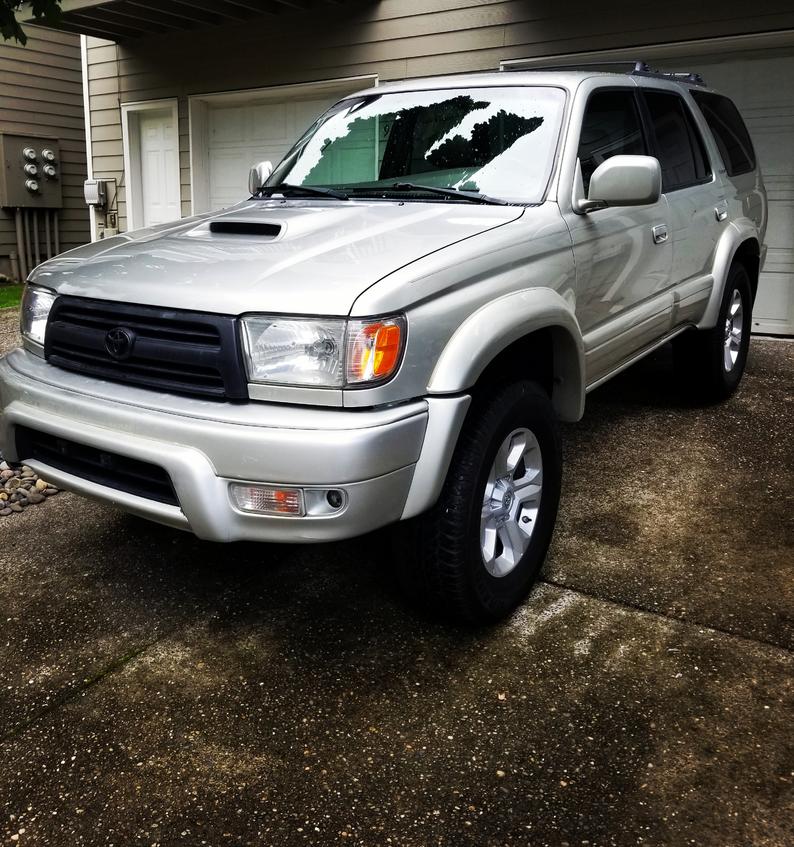

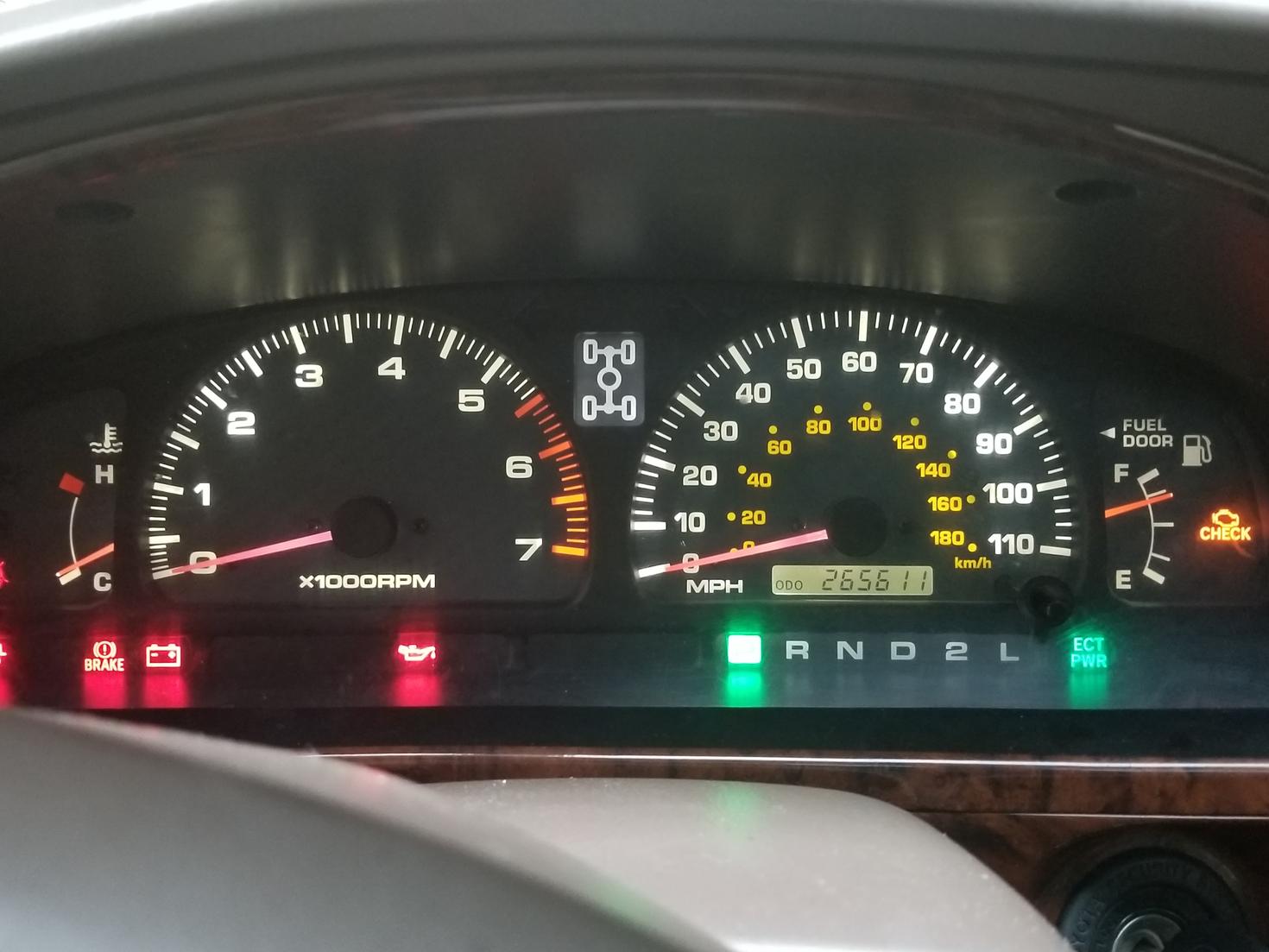

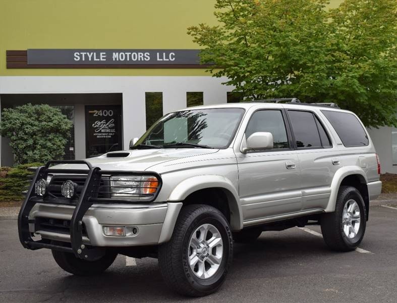

I sold my first gen in June of 2015 and took a year off from having a runner. I got the urge to have another 4runner in my life about 6 months ago and have always wanted a 3rd gen. So I searched and searched looking for the "one" when I finally found something decent enough for me to pay for. I found a 2000 limited with a first gen supercharger and hood scoop. I always liked the way hood scoops looked on 3rd gens so this was a no brainer that I needed it. Dude wanted $7000 and I got him down to $5200. She has 265000 with a clear title. I think she came with a lift but I haven't looked yet, seems to be maybe 2 inches. More to come in the future but I have a solid platform to start over. Any advice on best lift set ups, bumpers, interior, engine upgrades, or anything else is greatly appreciated.

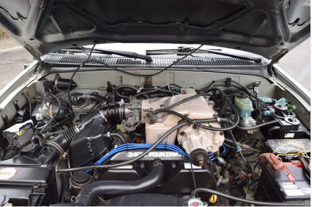

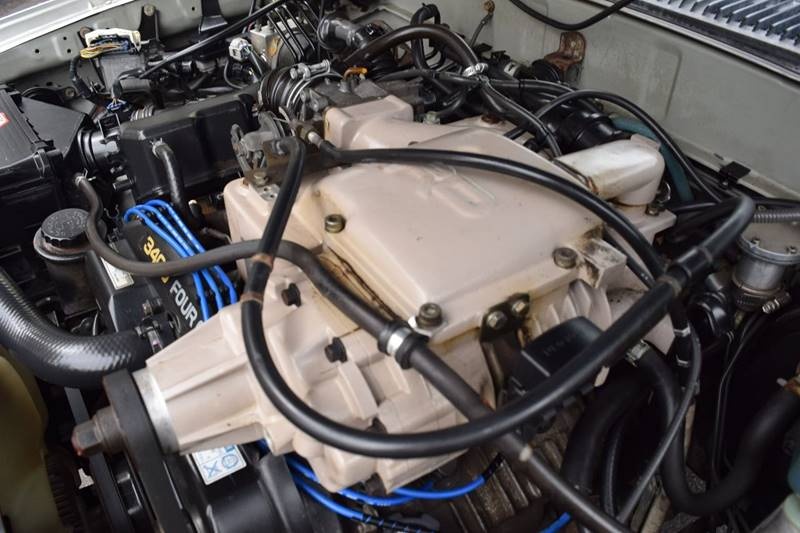

I spent the first few weeks of owning this upgrading the interior lights to LED, replacing the driver door power lock actuator, plasti dipping the front grill and emblems, and scrounging up missing parts like the cargo cover and rear seat headrests. I plan on doing a supercharger rebuild and adding the URD 7th injector kit. From what I have read on here I plan on doing the deckplate mod instead of a CAI, and adding headers and a new exhaust.

Nice rig! That grill would look amazing brought back to its color-matched glory ❤️

Thanks man. I hail from Beaverton. I plan on making some pretty significant upgrades to make this thing unique. As for the grill i dont know what to do with it and i plan on projector headlights with LED bulbs

Color-matched Satoshi and HID projectors, not LED
I'm not sold on the bug shield but it hides the paint chips on the front of my hood

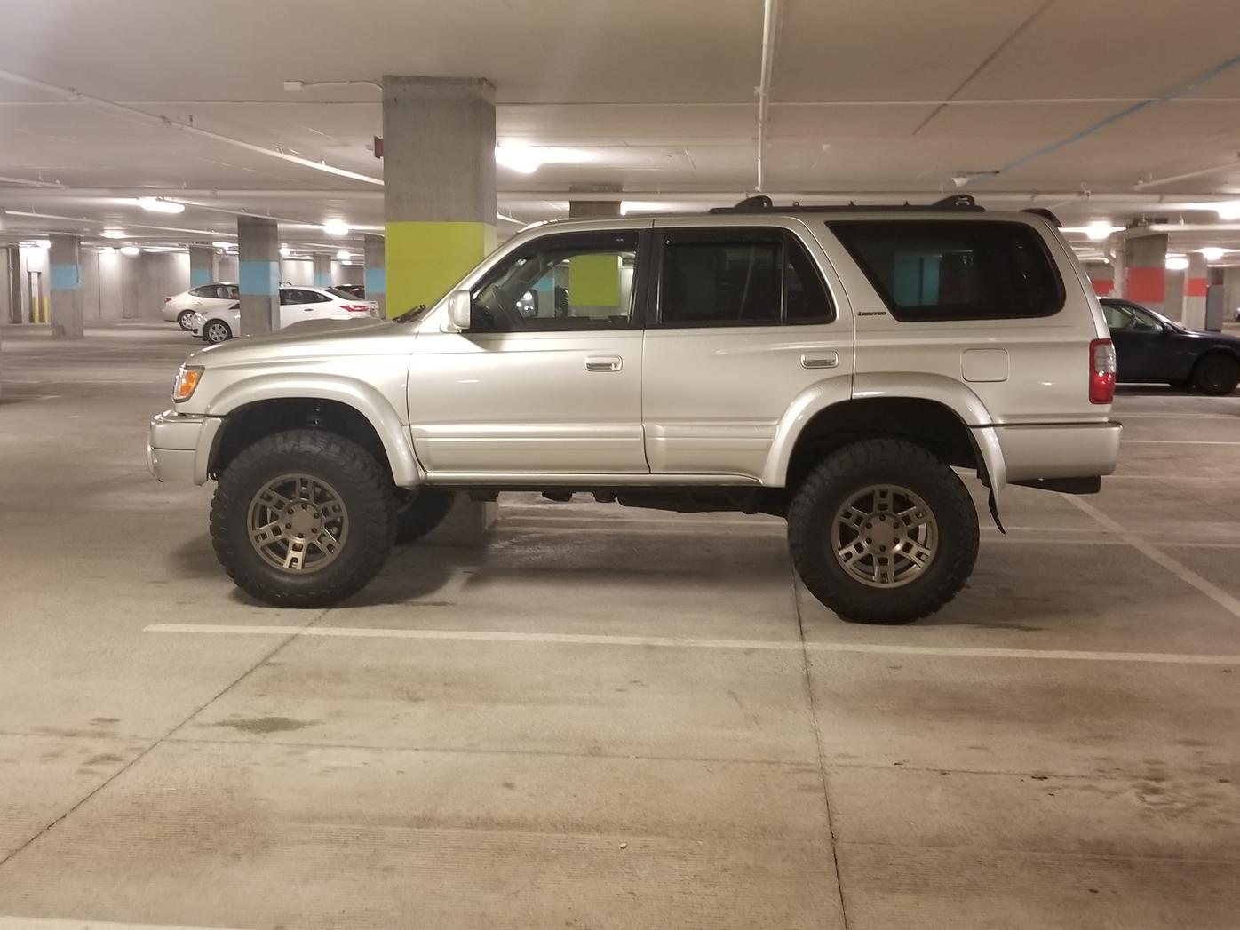

Front suspension:
Toytec/Eibach front coils
Toyota tundra Bilstein 5100's
Rear Lift:
LC 8 Wraps
Bilstein 5125's
This set up gave me a solid 3 inches in the front and 5 or 4 inches in the rear depending on what stock height is for a 2000 limited. Rides a lot smoother than the spacer lift it used to have.
