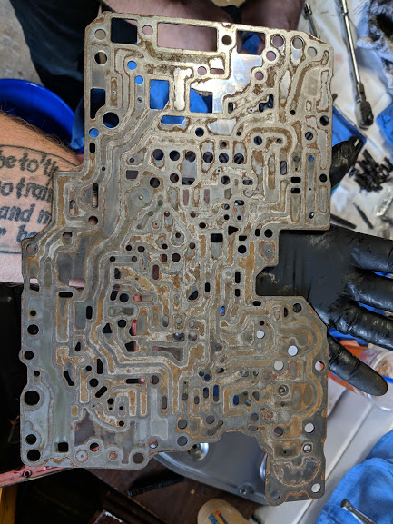

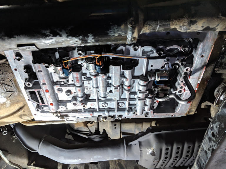

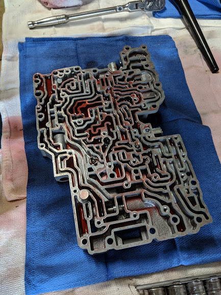

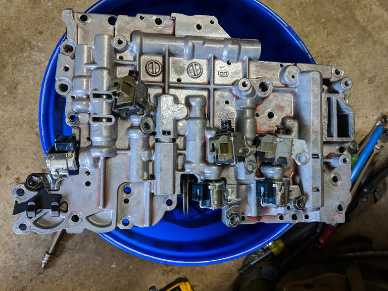

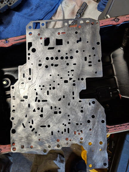

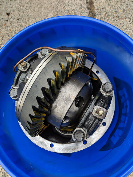

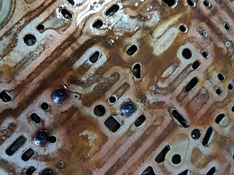

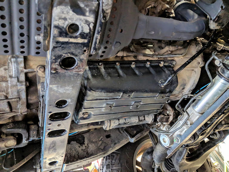

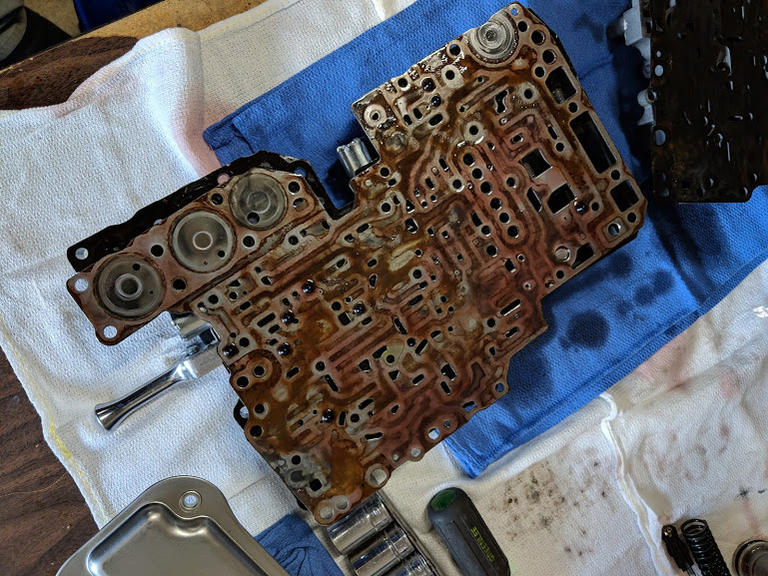

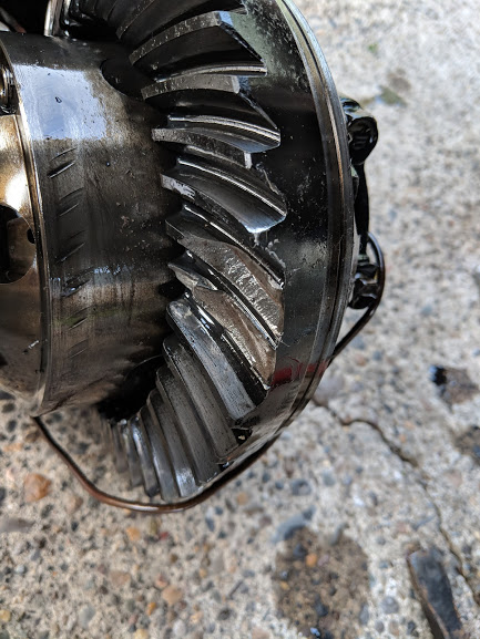

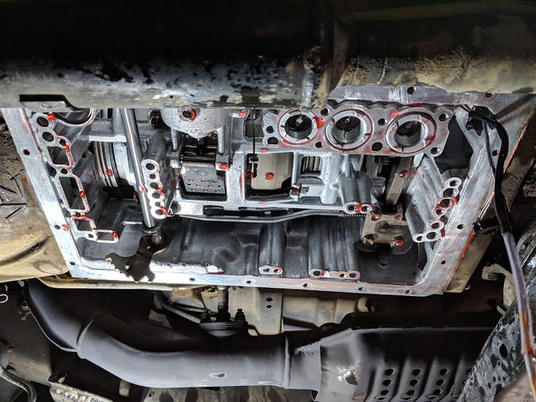

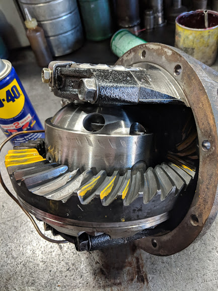

blew another ring gear this time due to a bad setup from the shop i paid to do it last year when i blew it on the trip you see a few post earlier where im in the river and in the snow ect... it was cold, the shop was full of other projects and i didnt feel like doing and so i paid someone to do... well that came back and bit me in the butt. they didnt take care to set it up correctly and set the pinion too deep so it was scaring the ARB and yet not getting a good pattern -riding too far out. this was addressed by beveling the pinion this time around to allow it to sit deeper and not contact the ARB. anyhow after all of that i ended up finally getting around to upgrading the valve body in the transmission as well as all new solenoids. im really happy with how it drives, its like a brand new transmission and it clearly needed some TLC...

yes that was rust in my transmission on the separator plate... flushed all the fluid after doing this and once again changed all (3) filters

That's some pretty brutal luck with the transmission woes. But... Now that THAT'S sorted, it is one less thing to have to worry about. Do you think the rust is due to water crossings where water got into the trans fluid?
