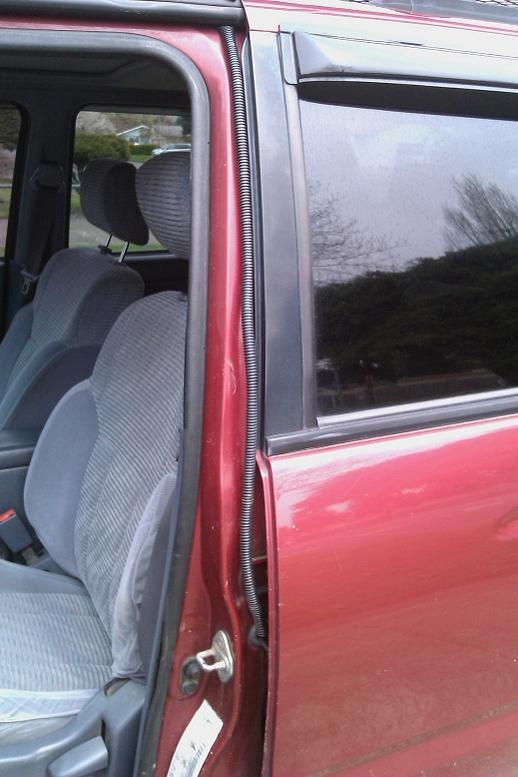

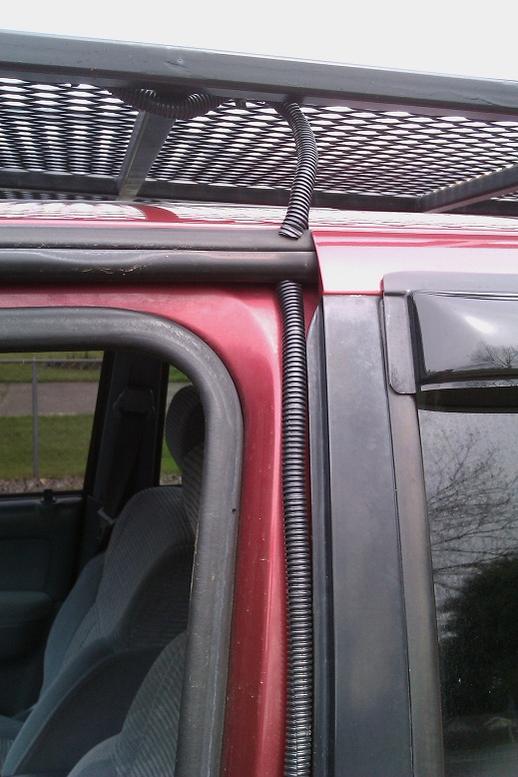

Hey Isaac, quick question: how did you run your wires from the roof lights into the cab/engine bay? Did you go into the roof rack track holes? Or go into the door jam and down the B-pillar?
I've got something in the works and need a good way to do this. Thanks!!
i ran down behind the outter seals, and down the B pillar between the front and rear doors, inside of flexable loom. i had to drill some small like 1/8" or 3/16" holes to run my wires through -one hole per wire, so i think like 4 holes per side. it works great because when i take my rack off i can just lay the wires down in under the outer seals...
as far as from there, they are all ran behind the interior trim panels to the firewall and through a hole and then along the motor side of the firewall to my relays...
