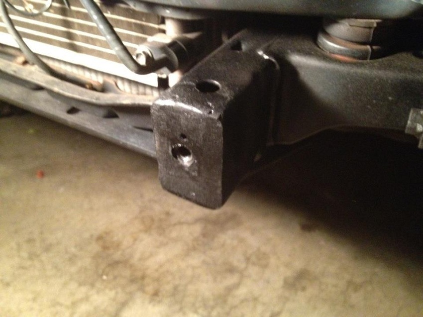

boxed in the frame rails/end caps and painted them. -painting them while the metal is still hot from welding is almost like powder coating... i think i did 4 or 5 coats of primer sealer, and then 6+ coats of semi-gloss black

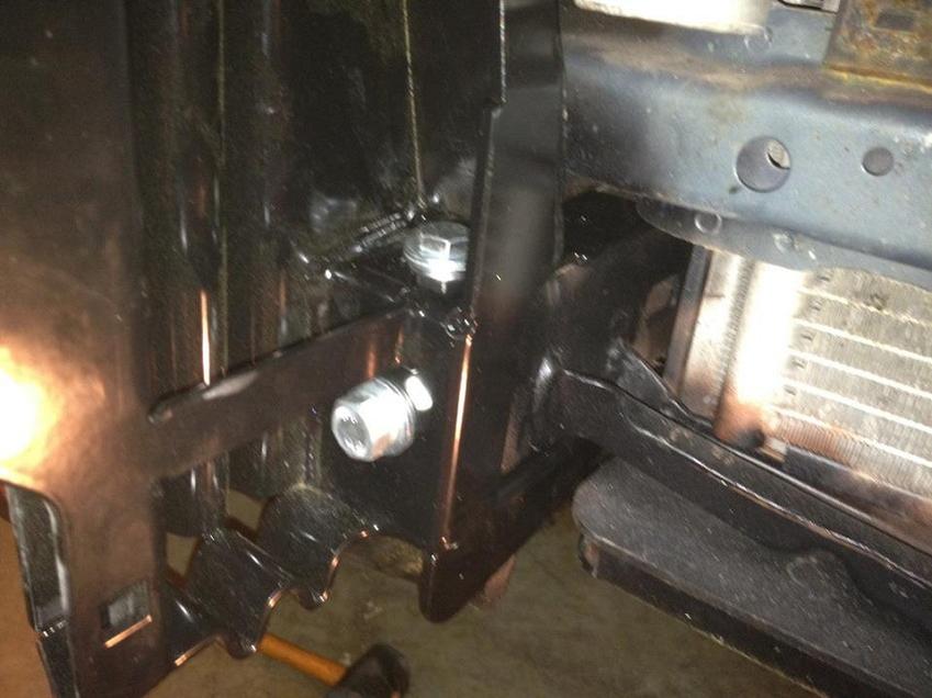

the caps i made are out of 3/8 plating, if i was thinking when i made them, i would have drilled a hole in them and welded a nut in behind them to really give the bolts something to bite into. as it is i ended up just drilling the hole and tapping the end cap, thankfully the only scrap steel i had laying around was 3/8" thick so its good enough, just not over built like i like.

Do you have any plans to run a bolt through the endcap? Thats what I did on mine to give me a little more hold to the bumper. I don't know if it matters all that much to the strength of the mount but I know some others have done it as well.

i could, but at this point i have not. i also have not added that 3rd bolt that requires you to drill through the frame through and through... i figure the winch is only held to the bumper by four bolts, so really imo the bumper only needs to be held by four. at a later date i could go back and redo the end caps with a nut welded in them for another bolt. my caps cetinally are strong enough i think i used 1/4" steel lol. we shall see how things look after a couple of pulls. -and i dong do much where im burried down in deep mud/muck. but i do get into some deep snow but i dont think snow will have as much holding power/drag as mud....

yeah so what i underlined there in my origonal post is bad thinking on my part, i didnt think about physics and forces... anyone reading this and thinking or going through the process of installing the ARB bumper especially if putting a winch in the bumper, needs a bolt through the end cap of the frame rail and the through crush bolt going top to bottom(or bottom to top depending). i made a pull with my winch with my bumper installed like this and i bent my mounting brackets. it put too much stress in the 4 bolts i thought would hold it just fine. and that pull was in snow. bottom line here, if you are not gonna instal a winch you could probably get away without the bolts through the end cap, but you will need the through top to bottom crush bolts. but if you are installing a winch you will need those end cap bolts -ARB desinged this bumper to have those bolts, they are needed!
i had to use the rectangle spacers provided by ARB in the hardware kit between my end caps and my bumper brackets. -they are the two rectangle silver pieces in the pic of everything laid out that are right above the small black metal "box". that metal "box" is what a few of the guys have cut up to make a end cap, as it already has a nut welded into it and there is two "boxes" that come with the bumper -they are parts that are used in the tacoma instal. i chose to make my own end caps as the ones i made are thicker.

For sure. I would agree that snow would be better than the mud. Mud sometimes doesn't want to let go haha. I actually cut up the frame extension things (those weird boxes that came with the bumper) to make my piece.
