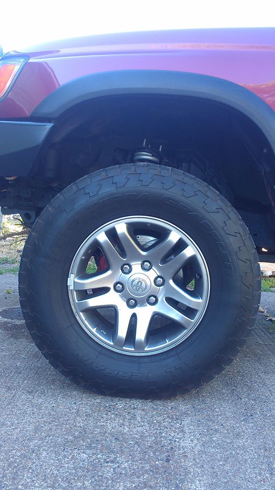

Issac has the Tundra 5100s with 5 clip settings. Nic has the Taco 5100's with 3 clip settings. The 2nd clip on the Tundra's is 0.65 inches of lift and the 2nd clip on the Taco's is 1.25 inches of lift. Big difference.
The Eibach coils should be 3 inches of lift which would be 23 inches from the center of the hub to the fender. I installed the Tundra/Eibach setup on the front of a stock runner and it came out to almost 23.5 inches. Im not sure why Issac is getting an inch less especially with it being on the second clip. I'm thinking his winch is just a solid chunk of lead.

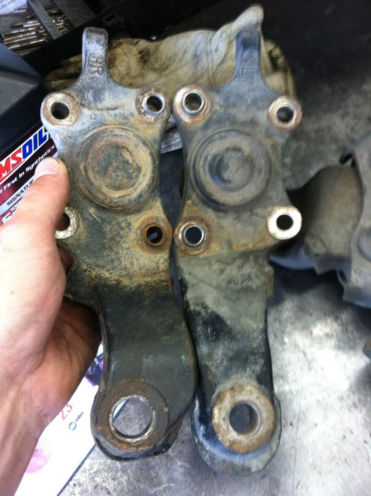

when you did this did you go with tacoma LBJs, or the 4runner ones? i am thinking about going with the tacoma ones just cause they are beefier, and that i have already replaced my LBJs a couple years ago when the first big scare came around with the failures... now less than 50k miles later im needing new ones -and yes i used Toyota OE LBJs. i have heard that they steer stops are more pronounced meaning you get a larger turning radius, but that might help not blowing CVs when out wheeling if i cant turn as sharp... idk
My most recent front end build had me going FROM Taco LBJ's back to the 4runner ones. I lost quite a bit of turning radius which sucked on the trail and around town.
Just cruising down tight trails it's nice to be able to turn as sharp as possible. Going up an obstacle you just have to discipline yourself pretty much.
The Tacoma ball joint is the same exact size, the only difference is a larger tie rod, but the 4runners tie rod is plenty beefy. I have never seen one get bent out on he trail. Unlike the 120 platform where they bend pretty frequently.
[MENTION=51127]Dous[/MENTION] well then, I guess that settles it, ill stick with the 4runner stuff as most of my wheeling is in the woods and on tighter trials... Thanks for your input.
Hmmm what your doing sounds super familiar to want I recently did. Only I just did the LCAs, bushings, cleaned up/anti-seized the cams, put LR UCAs, LBJs/OTREs. I don't need to do my rack yet though. Bushing are definitely probably needed. Gonna check play here this weekend.
Btw here is a good picture to show difference. Sorry they are opposite sides but you can see the difference. The taco LBJs tie rod hold is is closer to the wheel and the stop is definitely more pronounced. The geometry change is of the otre hole will make it so it won't move the tire as far.
