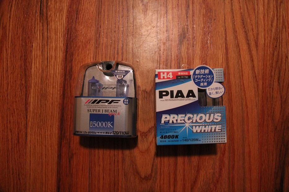

You have the ipf bulbs in stock headlights? Did you have to upgrade the harness? Where do you order them from?
i did, i dont anymore. ran them for a year or so. no issues at all. i loved them infact. i just couldnt find another set(the same ones anyhow) when they burnt out. i was running a 5000k super j bulb, it was still a 60/55w bulb but had the output of a 120/110w bulb.
i am now running a PIAA 4800k bulb, still a 60/55w but output is equal to that of a 140/125w bulb.
they look HID, but with out the glare that people hate. it gives a nice clean crisp light and its a focused light being that is a halogen type bulb, not an HID in a halogen housing.
technically neither of those bulbs are DOT compliant and are not for sale in the US, so i have to source them from japan.
to answer your question, no i have not touched the wire harness, have not needed to. i have no signs of overloading the harness or plug, and have never blown a fuse. i look for bulbs that only draw 60-70w of light max, the rest is all in the design of the gases/chemicals in the bulb and the type of element/filament, and the design of the bulb it self, to produce more light.
-note that these bulbs generally cost around $100 a set but far outlast anything else i have used that produces a "better light". silverstar sylvanias i have found to not last and burn out too fast, not to mention the light they produce is no where close to what IPF and PIAA bring to the table. and both PIAA and IPFs customer service is second to none while i have been told by sylvania that it was "my fault" and to go buy another set... -i did it was just a set of PIAAs lol

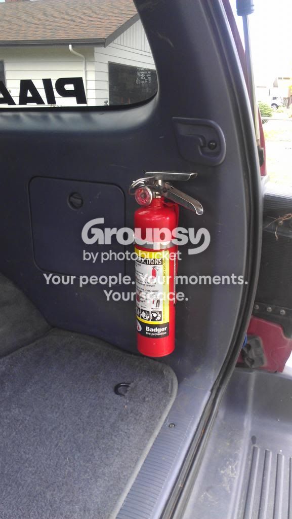

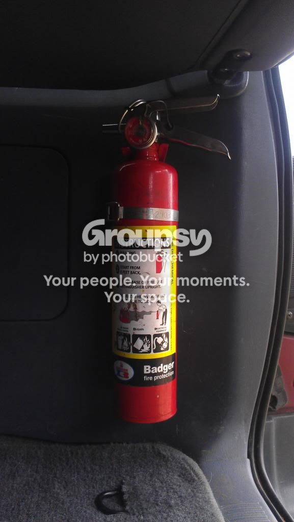

i installed a fire extinguisher the other day in the back of my runner. i mounted it so that the cargo cover still be useable and cover it, as its bright red and could attract attention.
IMAG29021.jpg~original
IMAG2901.jpg~original
What did you use to attach the fire extinguisher? I got one for Christmas and need to attach it in the same spot as you.
it had its own wall mount/bracket that came with it... the thing had been sitting around in my garage for a couple of years so i lost one of the band clamps that hold the bottle to the bracket, but i still have one of them and its holding fine. to attach the bracket to the 4runner, i just used some small screws and mounted the bracket to the interior trim panel. at first i was kinda skeptical about it, but its been doing fine, none of the screws have come lose and i was careful not to strip any of them putting them in.
i had the IPFs for roughly 18months i think... and most of my driving was done after dark i think i paid just over $50 for them -i wish i would have bought several pairs for that price. as far as the PIAAs the go for around $80-100 depending on where you get them(you cant find these state side, PIAA does not sell these in the US) and im not sure the life span on these, but if they are anything like the rest of the PIAAs i have owned they will last a couple of years at least. i have a set of intense white 4100k PIAAs in my 85 truck(did the hella H4 headlight conversion on that) sense i left for iraq so 09... 4 years(?), and have the same bulbs in my wifes car. she has had hers for over 3 years now, and its a daily driver and she drives with her lights on in the day time too.(does not have DRL). also the same bulb only in an H3 is what i have in all of my off road lights on the 85 truck, and the PIAA 940s that i was using on the brush guard. -those 940s i had wired up so the driving light portion of them was on when the key was in the "run" position, so they where my driving lights... on all the time when the truck was on or running. and i never had to replace them either. they hold up well to usage and vibration.

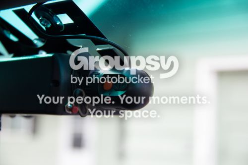

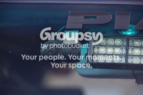

so i have been meaning and wanting to do this for almost as long as i have owned this truck, with in the first year of owning it, i have been in three accidents, and was getting very frustrated with insurance companies for not wanting to do their job ect. then with having a winch off of my 1985 toyota 4x4 pickup stolen this last month i was reminded that insurance companies are pretty much only a bunch of legal thiefs and are truly not on your side... long story short you need prof of everything these days, and its really sad but thats they way this world is getting. so i decided to just buy a dash cam for my daily driver.
IMG_1523_zps5b25a251.jpg~original

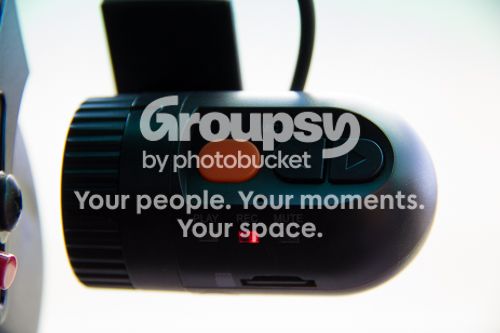

its a pretty simple camera, small, about the size of a film canister(yes i know i just dated myself), or Rx pill bottle. it sticks to the inside of the windshield, and has one wire that pig tails off and then splits into 3 wires, one power, one ground, and one audio visual cable plug in(the yellow one -not sure what its for and i didnt use it). at first i couldnt get the audio to work, then i realized i had the camera on mute... the little LED light under the word "mute" needs to be on for the audio to record, you simply turn that on, by pressing the oval orange button and then you are recording audio too.
IMG_1520_zps7992440f.jpg~original
IMG_1519_zps982c8c1a.jpg~original

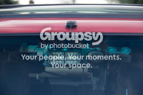

i mounted it just to the right of center in the windshield, next to my LED mirror strobe lights.

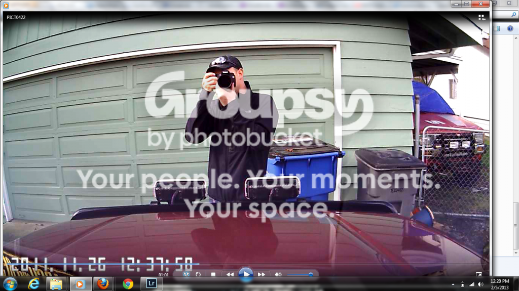

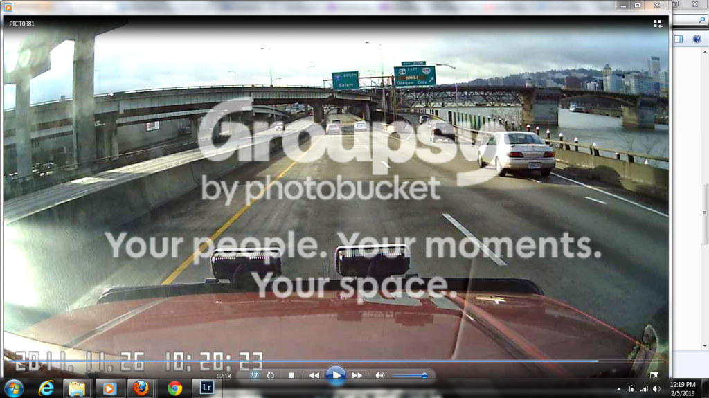

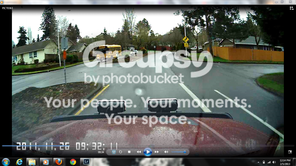

i picked this camera up for like $40 on ebay. it took about an hour to install from start to finish -but i hit all the wiring and pulled a lot of panels and to run the wires under and behind the dash and A-pillar. i also decided to wire it so it has constant power, so it is recording even when the truck is parked and tuned off... so i got to work and someone bumps me, i got it on video. i just have to check it within 24hrs or so other wise the camera will re-record over the files. once the card is full the camera will start recording over the earliest files progressively.
dashcamimage1_zps2850f2b9.png~original
dashcamimage2_zpsc78cabfa.png~original
dashcamimage3_zpsbb9468b2.png~original
-i have yet to figure out how to change the date and time, so those are way off... -the china-man who translated the instructions into english was well less than specific about things lol and so yeah im just gonna live with the wrong date and time... the video will speak for itself...

Got enough stuff by your mirror :photo:
I like that model a lot! And for $65 on ebay it pays for itself pretty quick if something happens. I want one now!
Have you tested the G-sensor feature where it saves that video?
How does that mic work, you just route it to where you want it to record sound, such as in cab or maybe in the front bumper or something?

for some reason the mic isnt working for me, but ehh thats more of a luxury at this point... the point was to be able to record vents as they happen and be a unbiased passenger/witness. video should be awfully compelling to an insurance company... and the mic is built into the camera, just above the buttons there are three small holes and the word "mic" above them so im assuming thats where the mic is, so it records sound from inside the cabin.
but as you said for $65(i only paid 41) its more than worth it.
i have not tested the g-force sensor, and im not gonna trust it either, im gonna just pull the card and and download the files or at least pull the card out of the camera so it cant record over them. -if the mic isnt working im not gonna trust the g-force sensor lol
yeah i think im about full... the Valentine One is perfectly located, then next to that is a hand held GPS on a suction cup mount (its got a 24K topo map of the US on it, and has most 4wd trails and old fire roads on it as well... comes in really handy in Search and Rescue, and 4wheeling, its very detailed, and then i have an LED strobe light behind the mirror. -you cant really see that because the rear-view mirror hides it so its not really obstructing any view. and then next to it is the camera, and again the rear-view mirror is hiding that as well from my view so yeah. -i have an amazing field of view compared to what i get in a HUMVEE

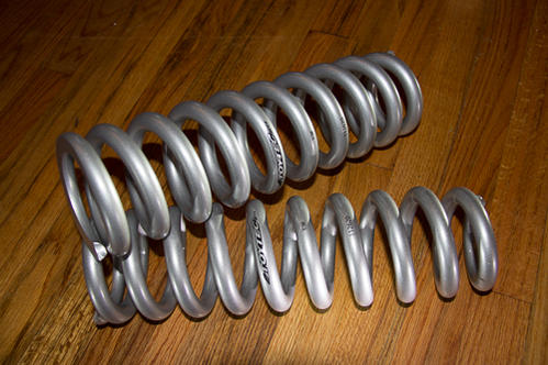

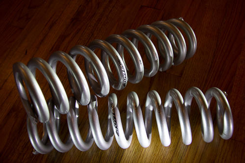

so i got something in the mail today, i ordered these from [MENTION=9139]steezemcqueen[/MENTION] at toytec. great customer service! and excellent shipping!

112620s? Your gonna love those things. I just made the swap from TRD Tundras to those and it's great! Can't wait to see them on the truck!
ok so i got my 112620s installed -the toytec eibach coils, set them on the 2nd perch on my tundra 5100s, they ride fine but i still want more lift. i will probably put in my 1/4" top plate spacers to add a bit more lift. -either that or ill be dumping my LC coils for some other rear coils... anyone have a good recommendation, i dont want more than 4" in the rear, i dont really like aggressive rake.
