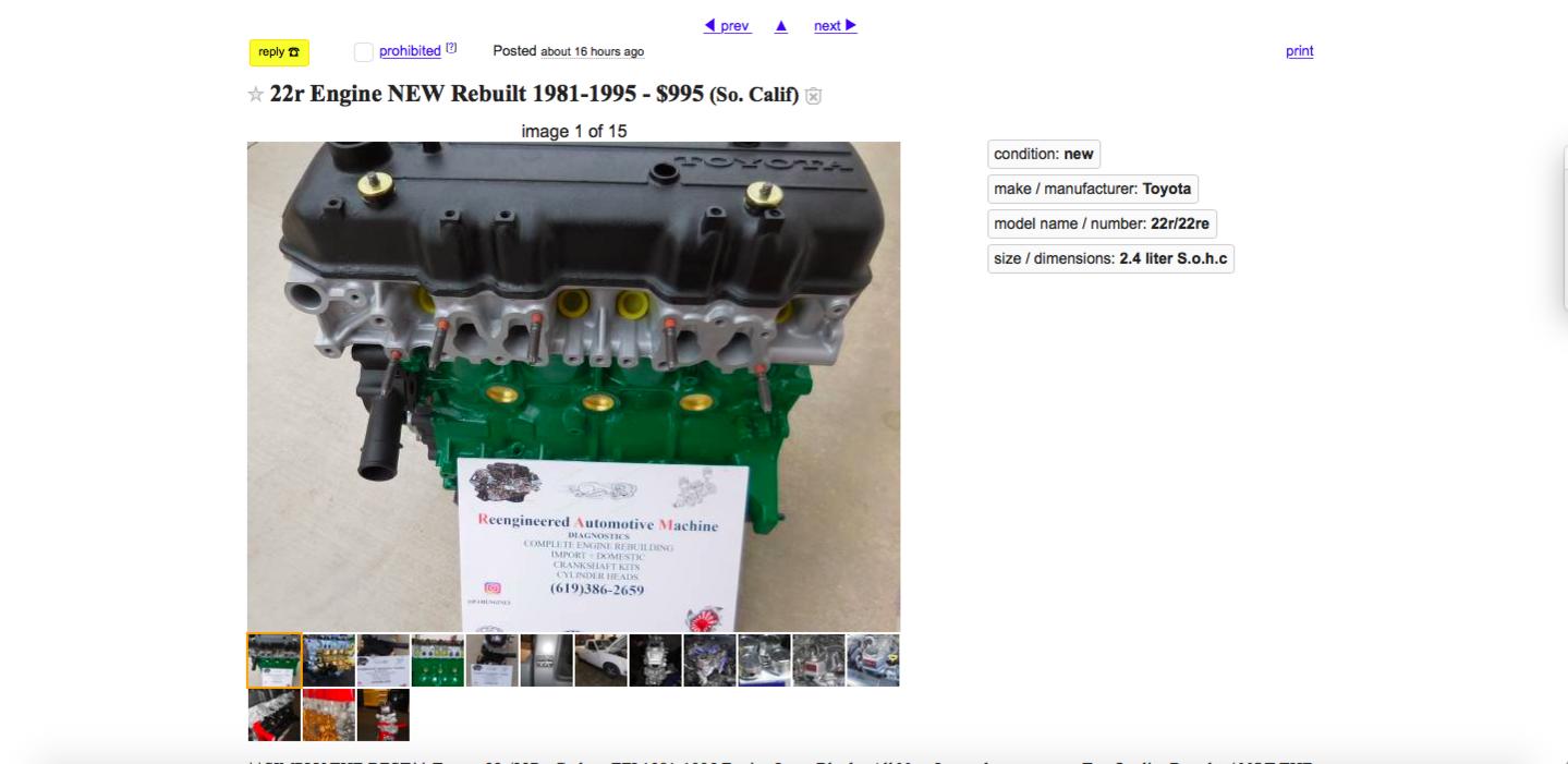

Well, found these guys. whole new long block for 1000$. this isn't too much more than I would be spending to rebuild it anyway. Thoughts? Screen Shot 2018-04-15 at 3.07.08 PM.jpg
