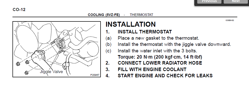

Per FSM

We all know that the Factory Service Manual can have mistakes in it, mainly with torque specs. But, I don't think the FSM made a mistake here. I've seen first hand it makes a 10+ degrees difference in the coolant temp. The Toyota engineers suggest having the jiggle valve at the 6 o'clock position for a reason.
I'd personally rather have my engine run a little cool than a little hot. When do engines have big problems? When they overheat. That 10 degrees difference might not be a big deal over the short term but after thousands of heating and cooling cycles, maybe it would. This could be the difference to ending up with a cracked head or a blown head gasket. Why do some engines make it to the 400k range while others have major issues at half that mileage? This could be one of the reasons.

Well, you said it. It's just your opinion and your experience with a totally different engine means nothing. For me and many others, I've decided to follow the FSM spec. You want to be a rebel? Go right ahead. It's your engine.

Everybody with some experience wrenching on other cars (even other Toyota's) knows that 12 o'clock is the norm. *BUT* the FSM specifically states something different than the norm, and it makes a well-documented difference in coolant temps...
The OEM thermostat is a 180*F (well, actually 82*C or 179.6*F) thermostat, which is the temp that the coolant should be going into the engine - by design and Toyota specification. The coolant gains temp/heat as it runs through the motor and comes out in the 188-191* range in most circumstances.
If the temps are much above that (read via the ECU or sensor in the top radiator hose), you are running out of cooling capacity (insufficient cooling or other problems) or your thermostat isn't doing its job correctly.
Before my most recent thermostat change, my coolant was actually running too cool (180-183*F) due to a worn-out spring in the thermostat. It was last replaced by a Toyota dealer in ~'03 - and yes, it had the jiggle valve down.
