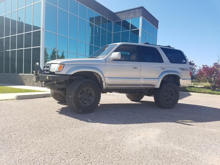

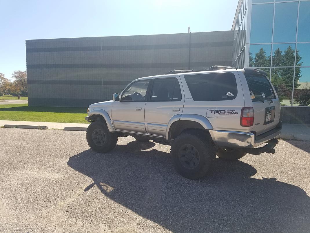

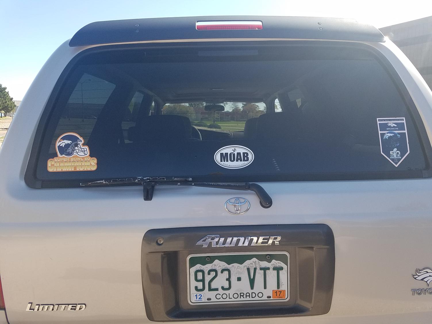

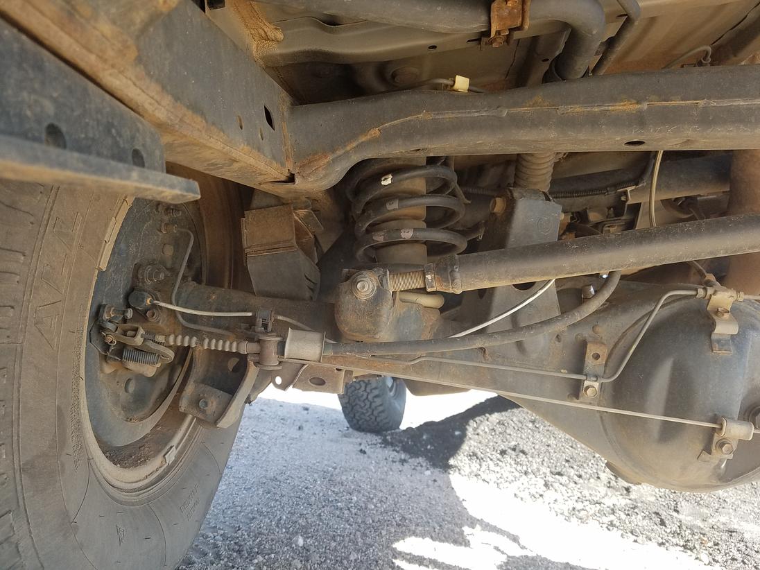

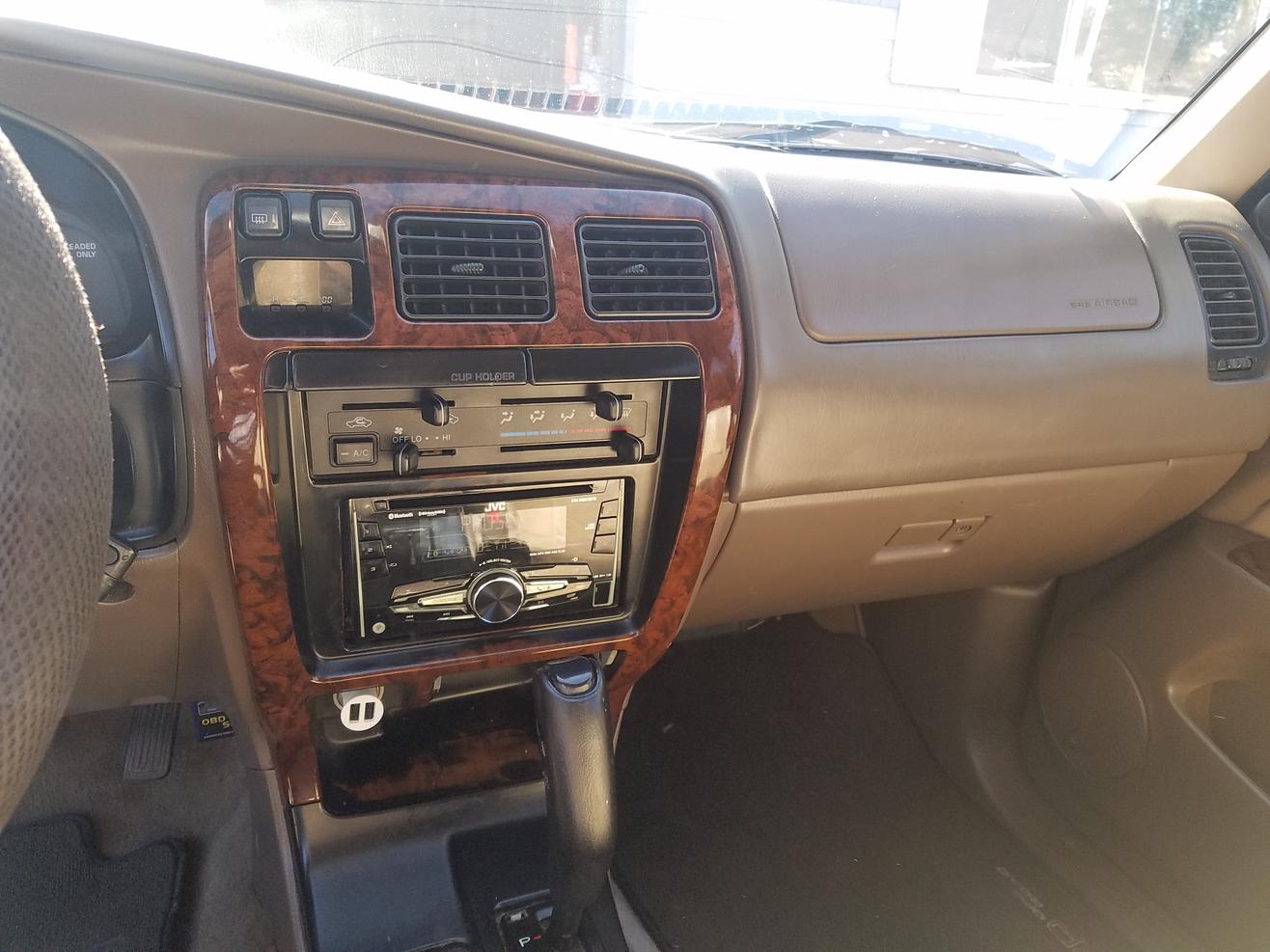

Will extended test drive and no issues. Man I feel better. Since I allotted time to fix her I just cleaned her up and added my Moab sticker from my truck this summer.

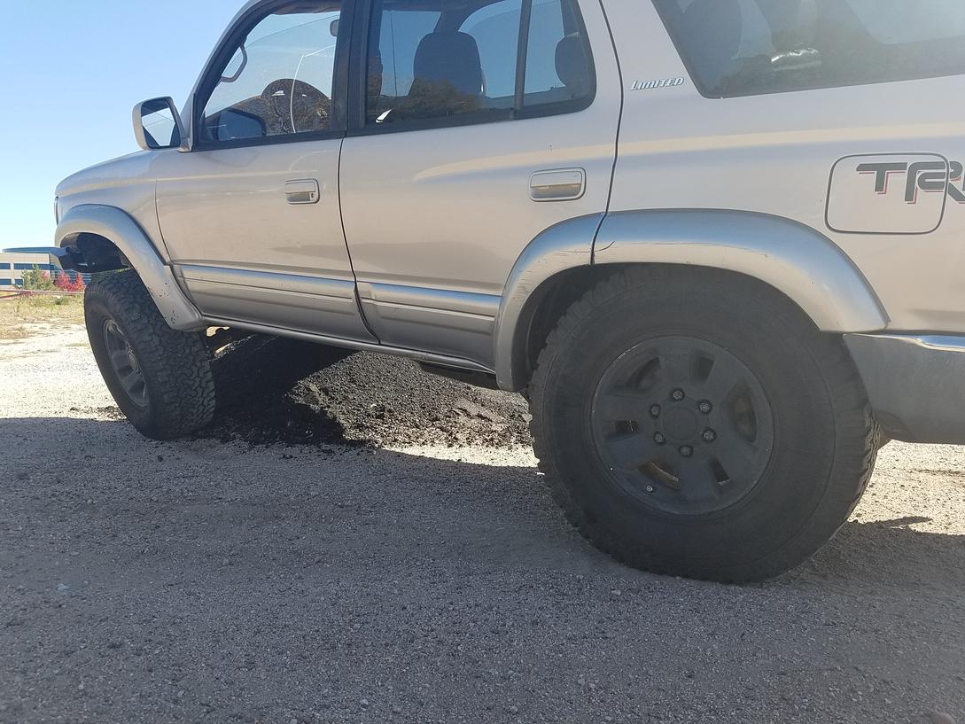

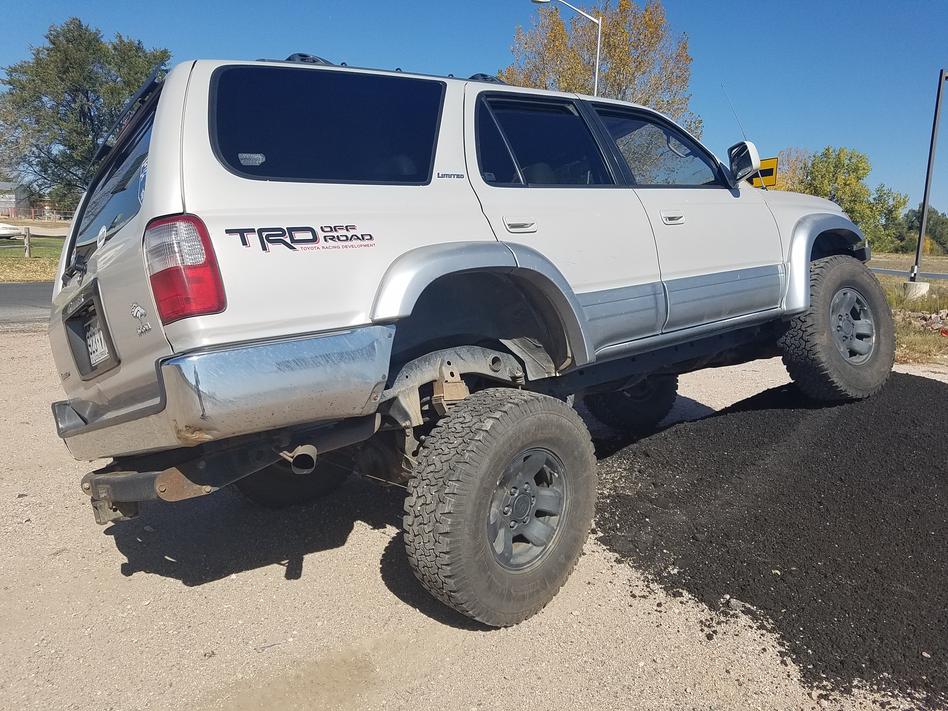

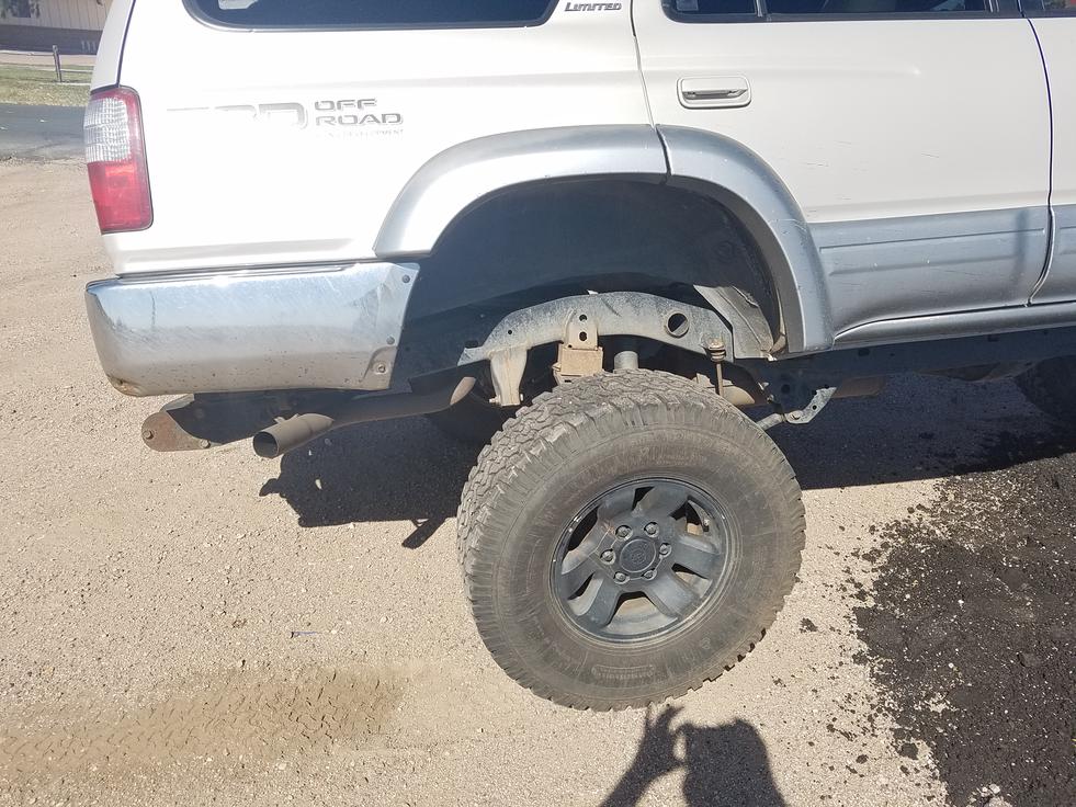

Also found this little happy hill of asphalt to flex her out.
