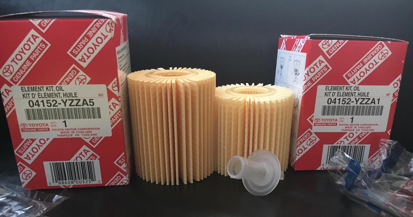

Maybe you can help me out. I changed my oil last night (I'm at 15k). I went ahead and let the dealer do my 10k service because it's free, figured I'd give them a chance, etc.
Long story short, the used filter I pulled out was a 15613-YZZA1 (AKA 04152-YZZA1). Diameter is the same, but it is significantly shorter than the 15613-YZZA2 (AKA 04152-YZZA5) I've been running (which I have a box of in the garage).
Seems as though the A1 is for the 2GR v6 motors in the Rav4/Sienna and some 2A 4cyl motors. I can't imagine they are interchangeable...are they?
Just wanted to make sure I have the facts before sending an email to the service manager.
Let us know how it works out for you.. If something ever happens to your motor down the road at least you have a record of Toyota changing it at 10k and using the wrong filter which makes them at fault..

perhaps I don't understand how this cartridge filter is assembled.
but it seems to me, you wouldn't have ANY filtration with that shorter filter in place. in order for it to filter properly, it would need to be seated and sealed on each end, that cant be possible with it being that short, right?
You are correct.

Like an aquarium filter at best. Like the proverbial screen door on a submarine at worst.:frusty:
Got home and verified, they have the incorrect part number listed on the service ticket as well. Wish now I would've paid better attention at the time
I was going to say check your receipt. Now go to the service manager and tear him a new a**hole.
Ooh got them in writing. Yeah if it was me, they'd at least be covering a nice ext warranty.

FIRST oil change for a 2018 4Runner at 4500 miles and the dealer used a RAV4 filter which is 3/4 of an inch shorter than the correct filter. I only took it to the dealer because I felt stupid passing up the free maintenance. Now I feel stupid for having it done.
How did this turn out for you guys?
What did you do?
Did the dealer do anything to fix the situation?
In my case, the dealer is only offering to complete a leak down test and an oil pressure test to identify any potential damage.
