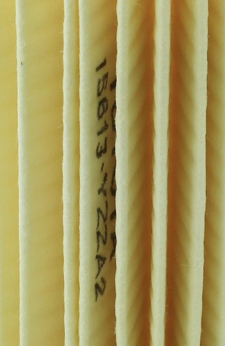

The official Toyota Parts Catalog (Toyota Parts and Accessories - Official Online Store) has no searchable text reference to 15613-YZZA2, 15613YZZA2, 015613yzza2, or any other derivation there in.
The part number for 04152-YZZA5 also has no mention of the above part number in searchable text. However, I think I just found my answer...
On the page for the 04152-YZZA5 I did find this image that seems to show the same 15613-YZZA2 part number on the filter itself... I must conclude as others have already mentioned that this is an internal part number to Toyota and not one they publish to the public since the part is only sold in the oil filter kits. I still find this super frustrating from a customer perspective as I try to ensure that I do have the correct parts.
I work in manufacturing and this is how material numbering is done. Each material has its own number. The upper level assemblies also have unique numbers: kits, assemblies, subassemblies, phantoms. The BOM components can be broken down as well to the raw material: filter media, end caps…even tolerance documents if you want to get crazy.

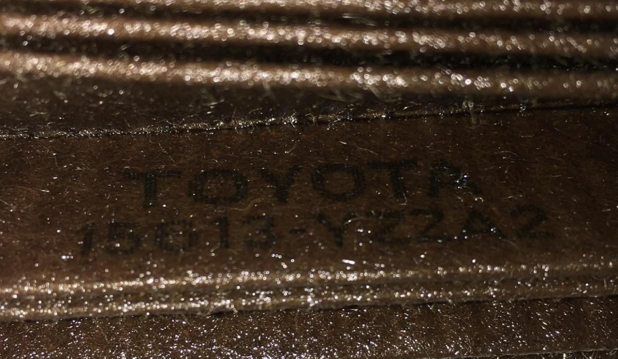

You can still see the Toyota part number on used filter media.
